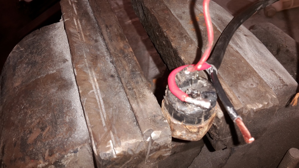

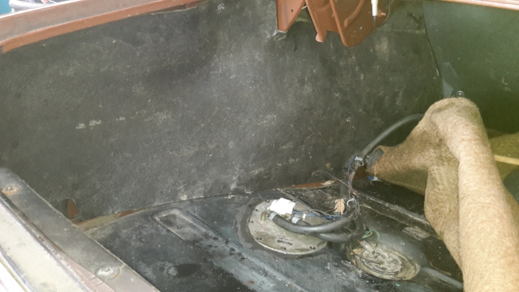

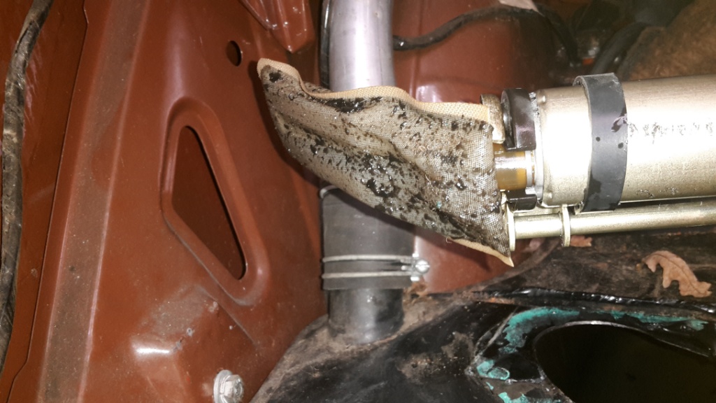

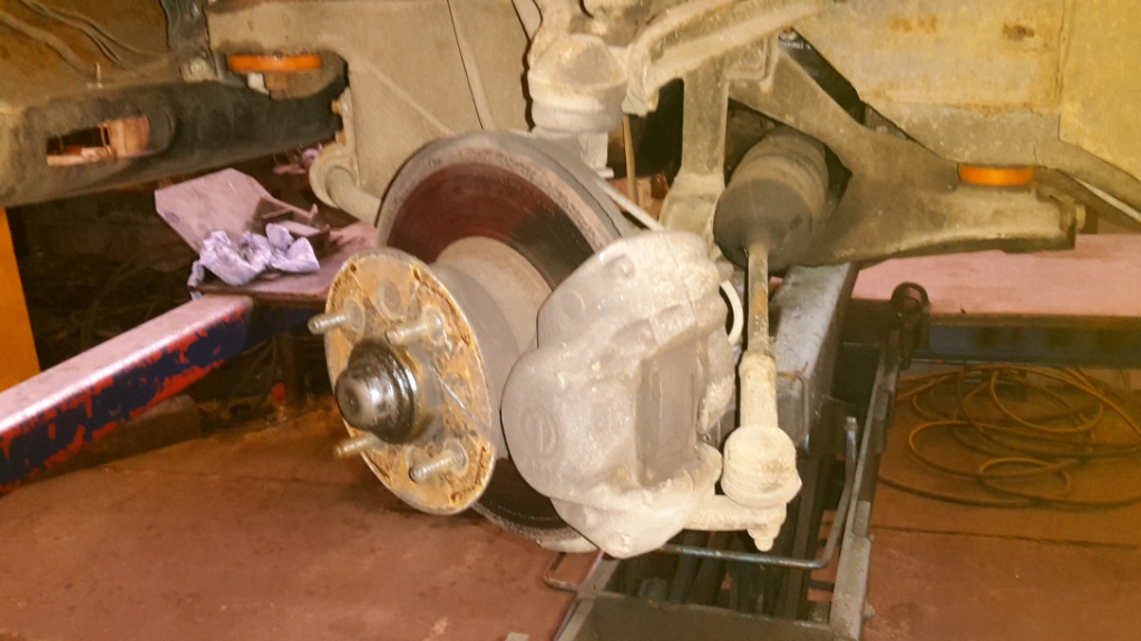

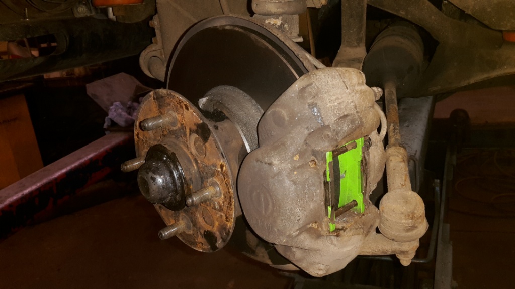

Recently I have just been doing little bits to car and also getting it ready for its mot next month. I have got a few pics that I will upload at some point. So the bits I've been fiddling with are taking apart and cleaning the door locks and they were getting stiff and while the door cards were off I lubricated the window winders. I had a smell of petrol in the car so I removed the in tank fuel pump and re sealed it. Fitted a new number plate light as the insides were too rusty to save. Fitted new brake discs and ebc green pads. It stops alot quicker now and I adjusted the rear brakes.

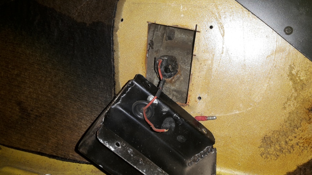

Finally got round to uploading pics.
Broken wire on reverse light switch
Soldered new wires on switch
Fuel pump suction filter
Re sealed fuel pump in tank and fitted boot liner
Before new breaks were fitted
New and old disc
New and old disc
New brakes fitted
New brakes fitted

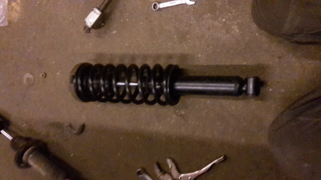

As the mot is coming up I thought I'd sort out the saggy rear end! Treated dolly to some new shocks and lowered springs. When I got the old units off I was able to spin and move the springs on the shocks! That would explain the rattling noise then! Didn't even need to use spring compressors to remove the top mounting plate. It sits at a better hight now and doesn't ground out also the handling has improved by miles and I've lost a vibration I had at over 50mph. It's a nice smooth drive now. Sorry about the quality of the pics was doing it outside. The ride hight has dropped a tiny bit now it's done a few miles and settled in.

Today dolly had its mot. It passed with only a couple of advisories. Super and lower front ball joints have slight play. If they were greaseable then they wouldn't have any play in them. Might be fitting grease nipples to some new ones if they don't come with any.
Posts: 7253
#171 Post by Carledo »
If you can find any, some original upper balljoints came with grease nipples. these are the much prized repairable ones which I believe the club (or possibly Alun) has rebuild kits for. So they are effectively "everlasting".
As far as I am aware, NO lower balljoints came greaseable, however I have been tempted lately to experiment with installing a grease point in one of the several used ones I have in stock - how hard can it be? If this works then I have a number of NOS lower balljoints that could benefit from the same treatment before I market them.

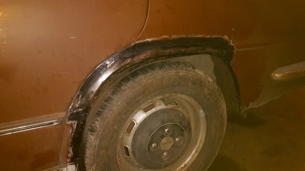

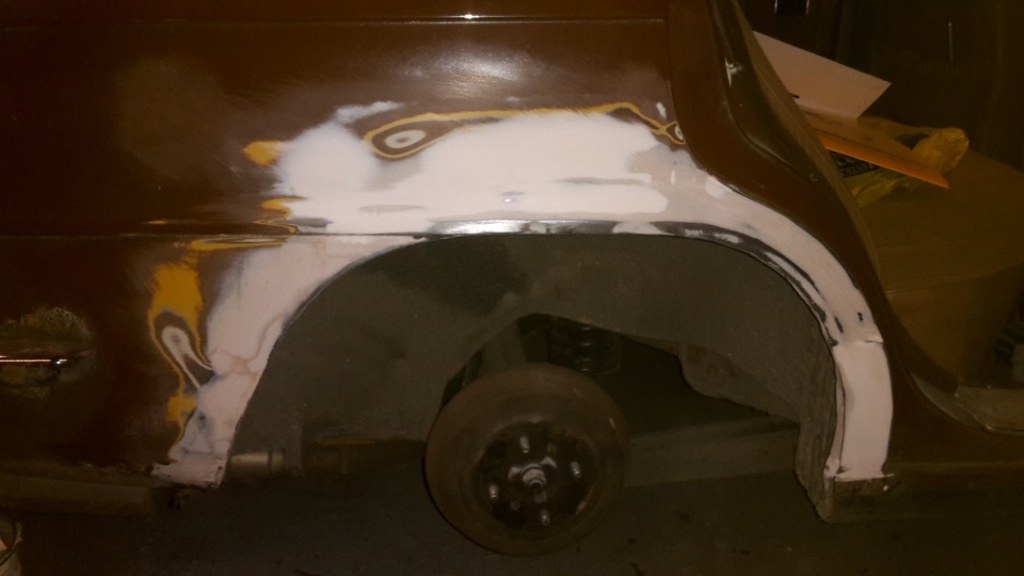

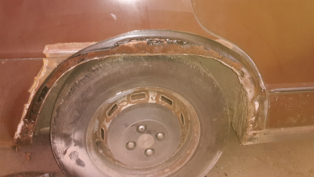

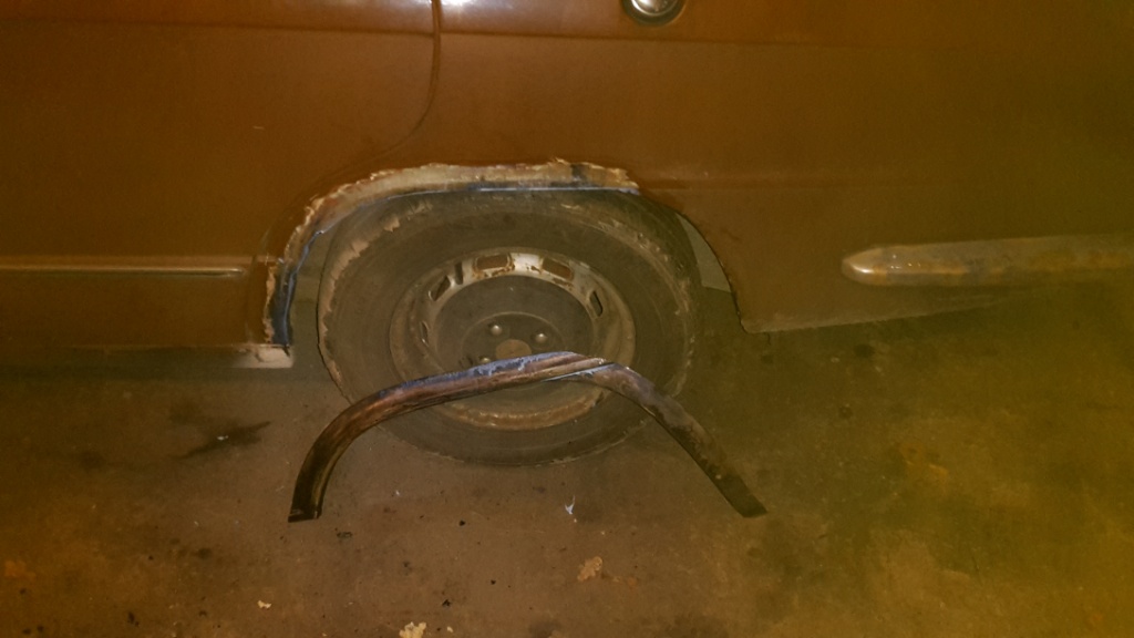

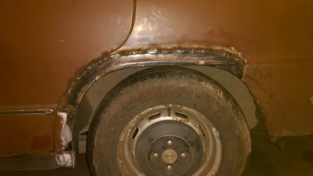

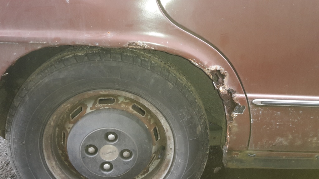

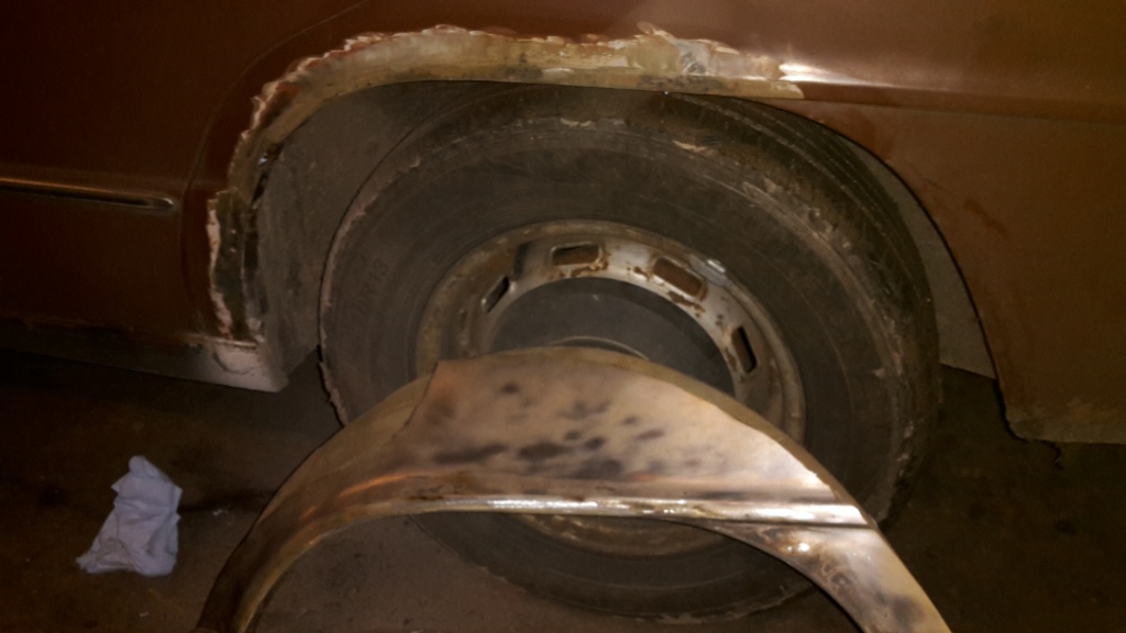

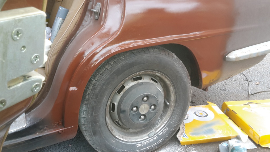

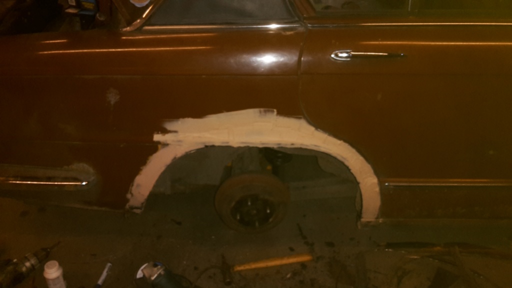

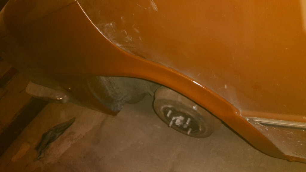

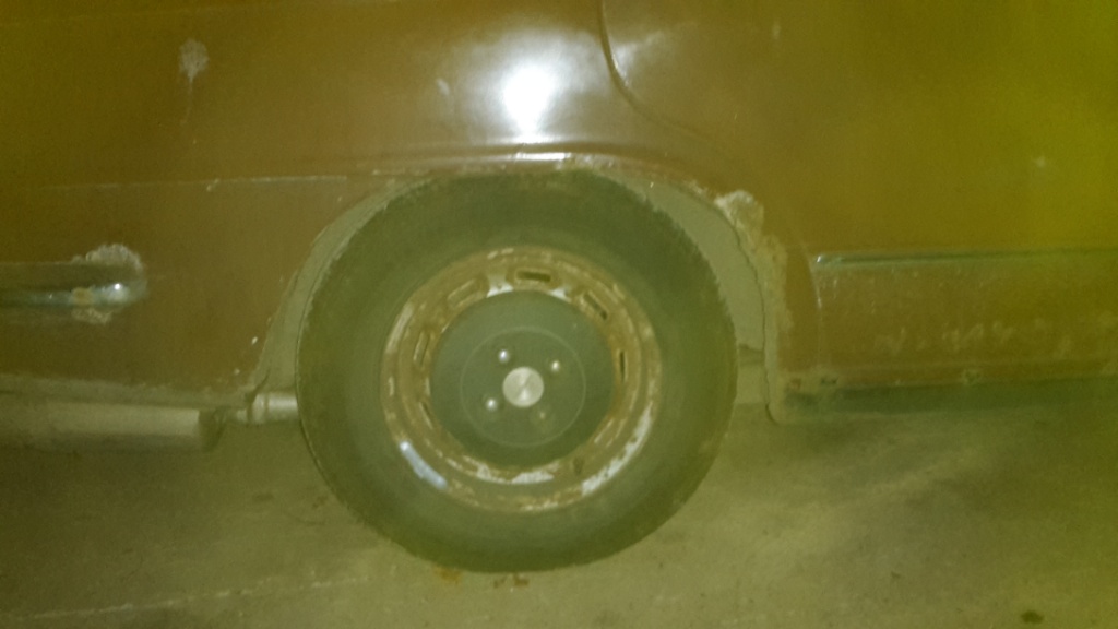

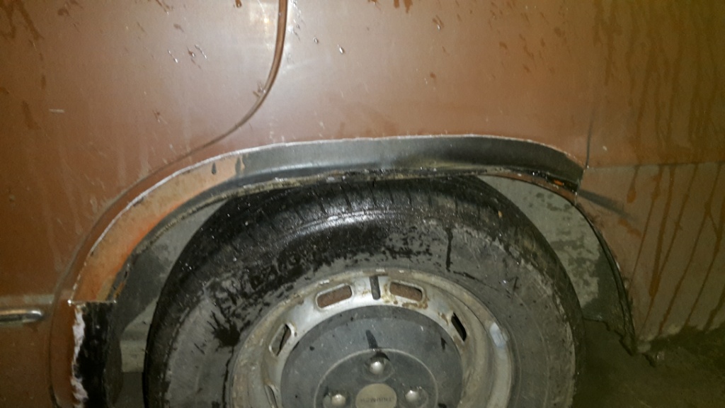

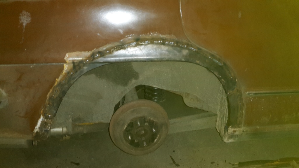

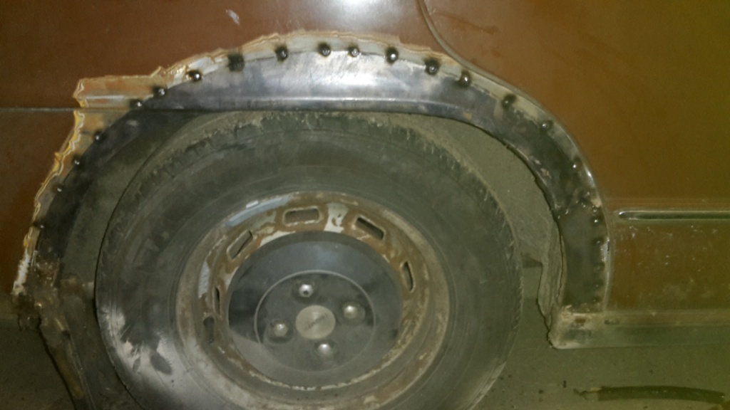

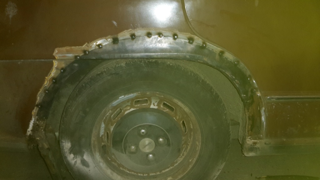

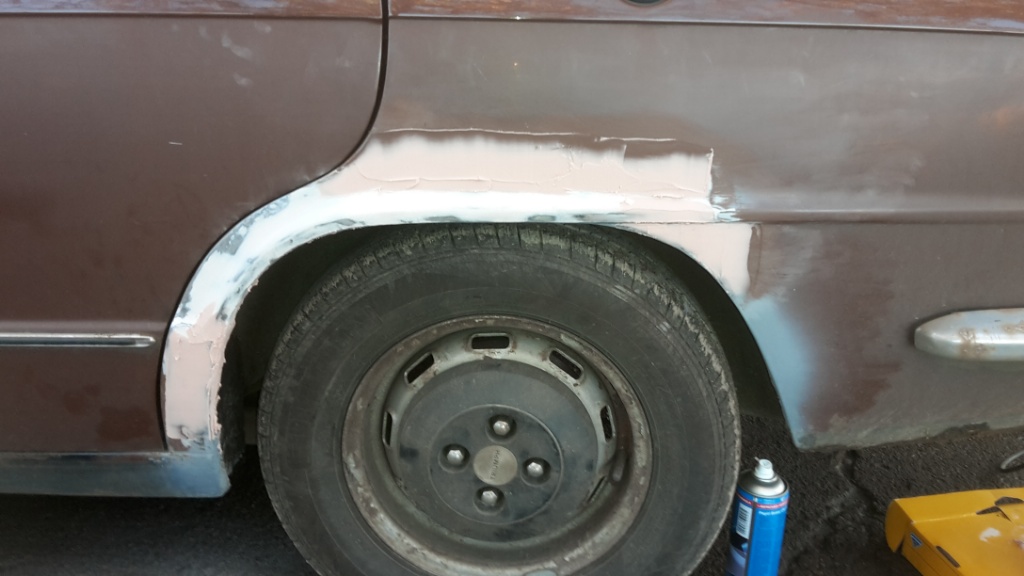

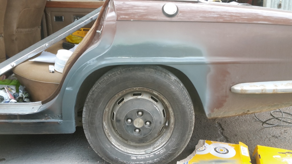

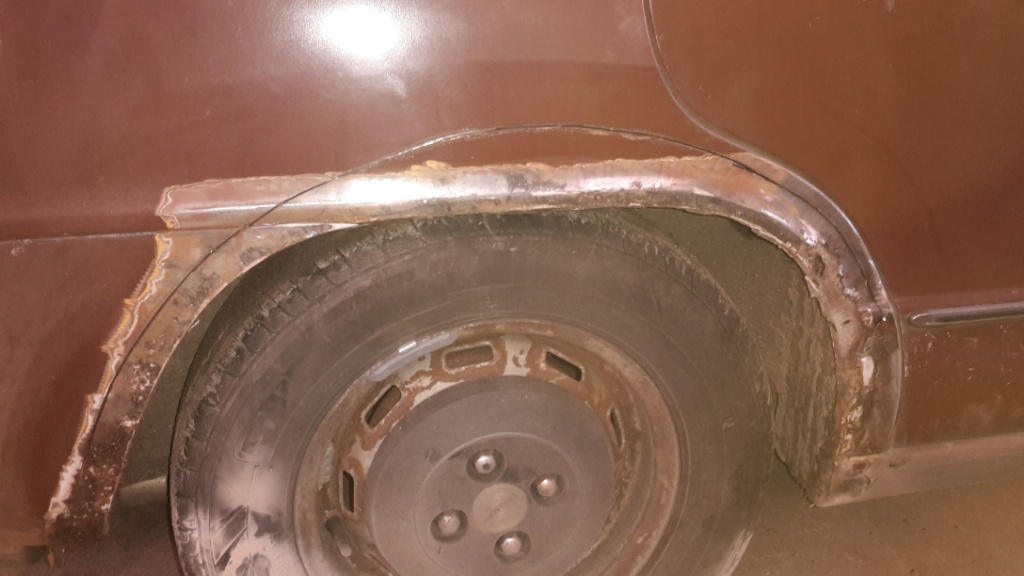

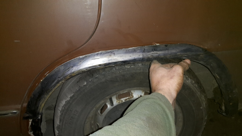

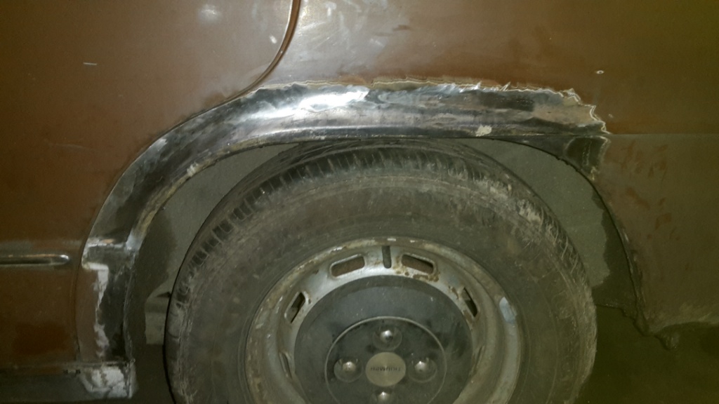

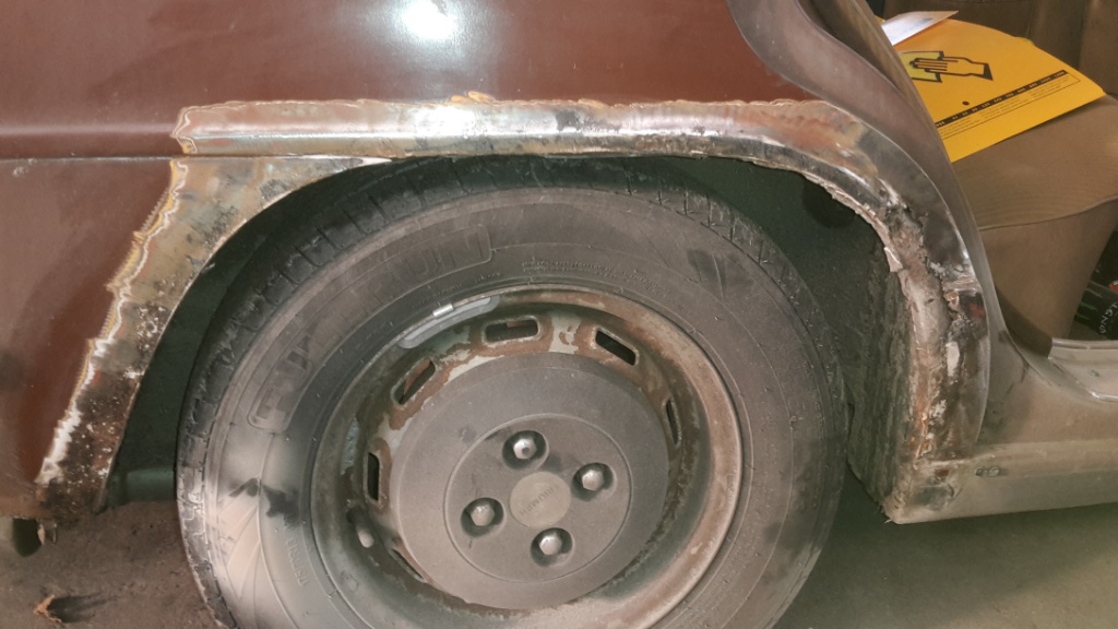

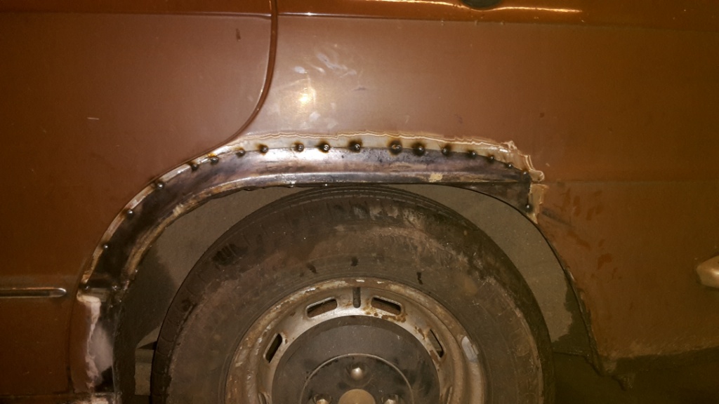

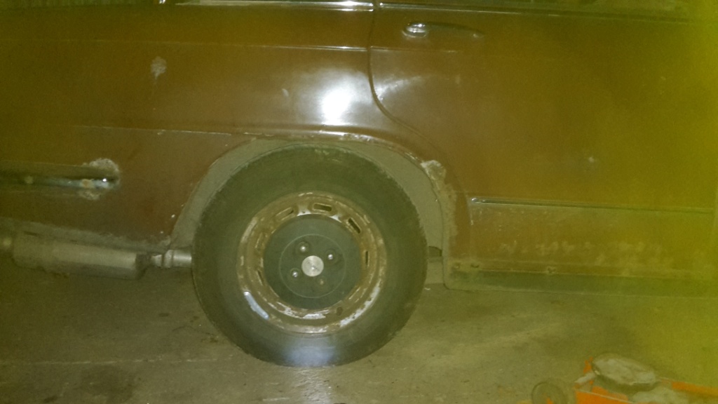

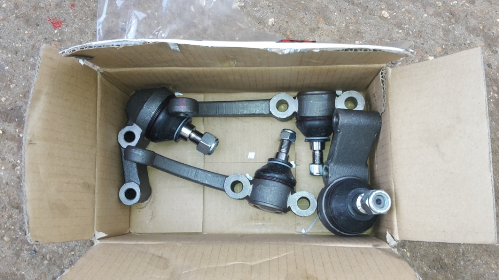

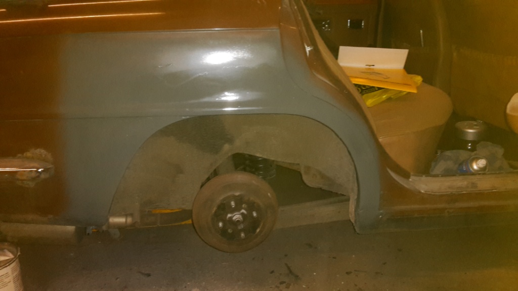

Latest update is I've repaired both rear wings. They still need finishing off properly but they are both solid with no holes and roughly the colour of the car. I've also ordered a set of 4 ball joints for the front suspension as they car is wondering a little now! I apologise if the pics come out in the wrong order coz there are a few!
philgroom
#178 Post by philgroom »
Some more pics
philgroom
#179 Post by philgroom »
Some more

Got a little more done to the dolomite over the weekend. My new ball joints arrived so I fitted them. Then I realised the front wheels aren't facing the same direction. As I couldn't get the car on the ramp I roughly adjusted the tracking with a tape measure and it already handles better. As soon as I can get it on the ramp I will do the tracking properly.
