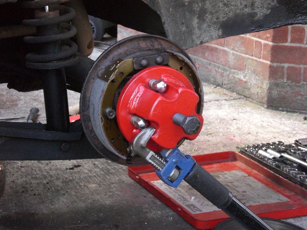

Before I bleed the brakes I pulled both the halfshafts out to replace the bearings.
Wheel off, drum off and puller on...
This is the puller you need, from Ian Gittings on eBay...
https://www.ebay.co.uk/itm/TRIUMPH-SPIT ... 2749.l2649
If it wont go tighten the bolt with a breaker bar then hit it with a hammer it will pop off. Oh and be prepared for a bang!
Then you can unbolt the backplate, leave the brake gubbins on, you only need to disconnect the line and handbrake.
Then you can use a slide hammer to pull the shaft out, sorry forgot to photo that bit.
The one with the red tape is the drivers side.
Click on the photo to view the video, the bearings are completely shot, I'll just replace them.

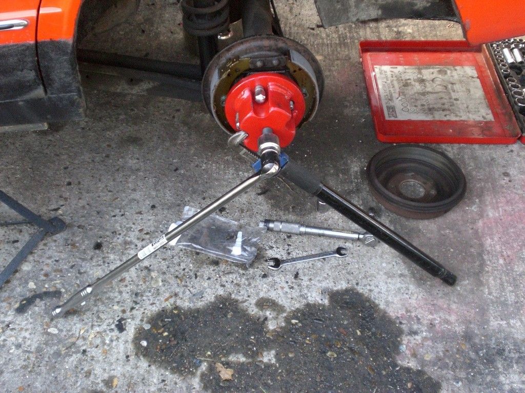

So continuing the wheel bearing replacement
Pressed the old bearings off the shafts, took about 4 tons of pressure to make it move.
Shaft looks good with no damage
Pressed the new bearings onto the shaft to the specifications in the workshop manual. What happens is that when you tighten the hub up it draws the shaft through the bearing and ensures that it is positioned in exactly the right place to avoid extra load on the drum. Thanks Jeroen for explaining that! :D
New oil seals in the axle
New bearing packed with grease
Install shaft in axle. You'll have to turn it to make it engage in the diff but you won't need a hammer to get it in. If it won't go pull it out turn it and push it back in.
New oil seal and gasket on bearing retaining plates
Install brake back plate, don't forget the oil catcher. Torque nuts and bolts progessively to 18ft lbs.
Install hub onto halfshaft make sure it engages the key.
Torque hub bolt to 85ft lbs.
Done, just need to reconnect and adjust/bleed the brakes.

Hi James, just as a matter of interest how do you stop the hub rotating when you use that big puller please ?

A very big lever bar! All I do is get the bolt nice and tight with a breaker bar, then hit the head of the bolt with a large hammer (whilst standing to one side!) If you have enough tension then the shock will break the taper and the hub will pop off.
A stilson and a trolley jack handle works:
