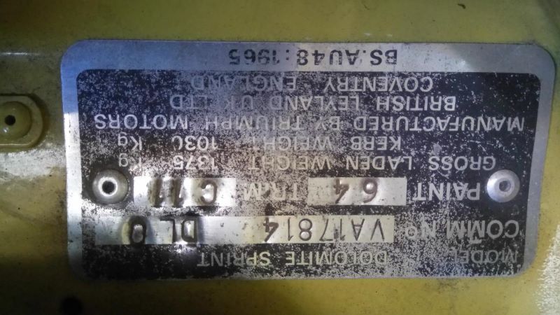

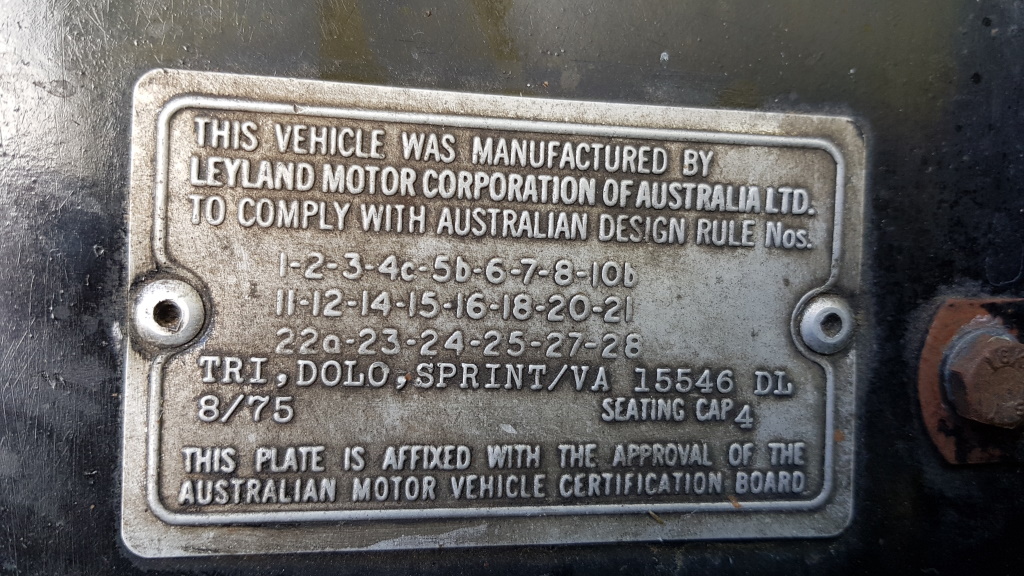

DLO or DL ?
#7 Post by gmsclassics »
Interesting point as my ex Australian Sprint has the DLO suffix on the commission plate attached to the car at the factory, but the plain aluminium plate attached by the 'Australian Motor Vehicle Certification Board' nearby on the nearside inner wing just states DL. That also states 6/76 which I assume is when it was in Aussie and complied for the road. It also states it was manufactured to comply with three stated Australian standards which I have always assumed relate to the device to capture fuel vapour / overflow fuel and return it to the tank. That is the only difference I found from 'standard' Sprints.
The full chassis / commission number is stamped on the top of the nearside suspension turret, parallel to the wing, between the outermost two nuts on the shock mount. I imagine that this could easily become 'lost' if the car has ever been repainted.
My car came across to NZ in 1996 and as it was a new import now also has a modern 19 digit VIN plate. Fortunately the original two plates remain in place just for the authenticity, but of course are legally irrelevant in NZ.

re compliance plates and body numbers: curiouser and curiouser. Cursory interwebz research tells me compliance plates were not mandatory prior to 1989, but were fitted anyway as a convenient proof for registering authorities that the vehicle met certain legal standards. Apparantly prior to 1989 it was not a requirement for the plate to remain on the vehicle after the first registration. Probably, mine just got lost at some point. When it is light, I am going to rummage on the firewall for the rivet holes where one may have been attached. As far as the body number stamping, yeah, it could be right there under the repaint as that side of the vehicle had been damaged and repaired decades ago, or that inner guard was replaced with a new blank panel.

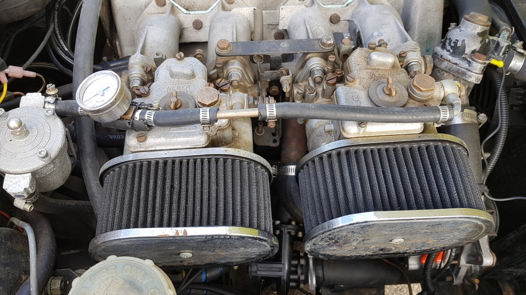

Lovely job mate..and 45 Webers!! :thumbsup: :thumbsup:

#11 Post by DML »
For that extra loud induction roar! Actually, they are very loud. A company in Melbourne makes a filtered cold air induction box feeding in from the grille. Apparantly it will quieten these babies down quite a bit. On the list...
A pic in there of the electronic ignition and electric water pump.

On the cursed "O" it was put on the plate to denote a car fitted with Overdrive at the factory, standard 4 speed cars just had the DL. (which is the code for a RHD car, correctly speaking a "domestic market RHD car" but we'll gloss over that being as BL DID send them to Oz) No Dolomites got stamped in numbers in the shell until the series 4 cars of 1979 when the early 11 digit VIN was introduced. So it's not on ANY Oz market cars which were all series 2 cars.
