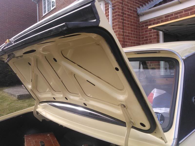

I'm using this type of seal. It seals ok and is pushed on the body edge and not in the bootlid. I thought mine was from an old alfa what we have on a big roll. The rubber lip what i use is a bit higher as in the picture.

The alternative I used is the same as fitted to late (UK built) T2000/2500S.Robert 352 wrote:Can anybody put up a cross sectional view of what this alternative looks like, or even better, can anybody provide me with a sample so I can see if we can source it locally up (down?!) here?
I will endeavour to post a photo tomorrow.

As promised.......
hope this helps,

Ian and Jeroen have both provided photos of alternative seals for the boot and I am sure I can find something available here locally.

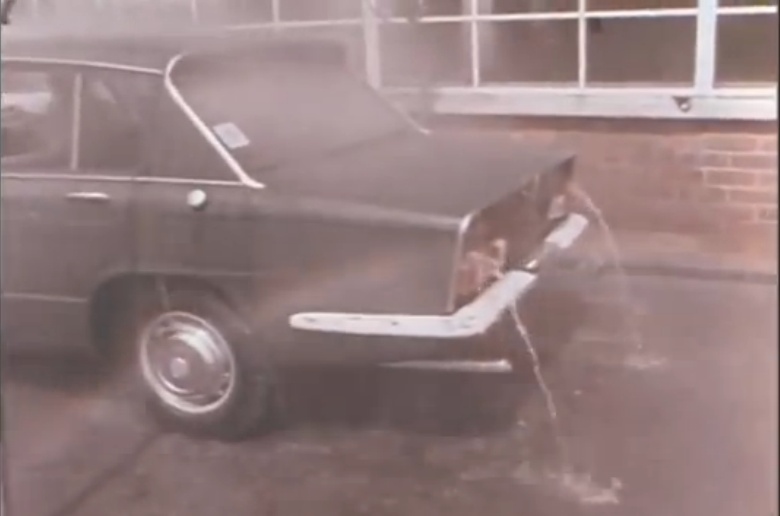

I think this factory footage of a 1500 shows (more than) adequately how much water is channelled over the rear lights, even when water from the roof finds it's way down the channel around the boot;
I replaced my boot seal with a traditional one from Rimmers,, this was because I was getting an annoying "click, tick, click" coming from the boot lid whilst the car was in motion as it clattered on it's catch. The boot now needs a firm push to shut it properly;
Watertight and no chattering.
