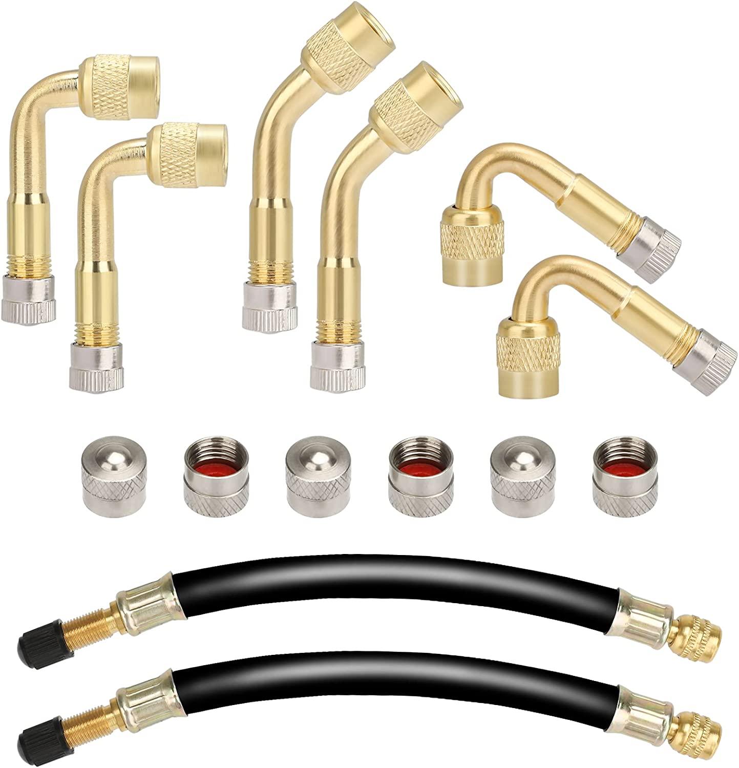

Schräder Valve Extension Hoses & Fittings
It’s surprising how many Schräder valve stem options exist, of which those listed on the following website, are what I have discovered so far:
https://www.liquisearch.com/schrader_valve
https://www.liquisearch.com/schrader_valve/dimensions
In addition to Schräder-valve extension hoses, there are also a variety of rigid, angled extensions with angles of 45º, 90º & 135º plus possibly others I have yet to discover. These, in combination with extension hoses, offer considerable scope for checking & adjusting the inflation pressures of spare tyres and air-pressurised windscreen-washer reservoirs etc.
6Pcs Tire Valve Extension, Tyre Valve Extension Adapter 45° 90° 135° Degree Angle Valve with 2 pcs 180mm Rubber Tyre Valve Extensions 6Pcs Metal Caps for Car Motorcycle Bike Truck RV Scooter
https://www.amazon.co.uk/dp/B0B7BBWCBL/ ... 9kZXRhaWwy
