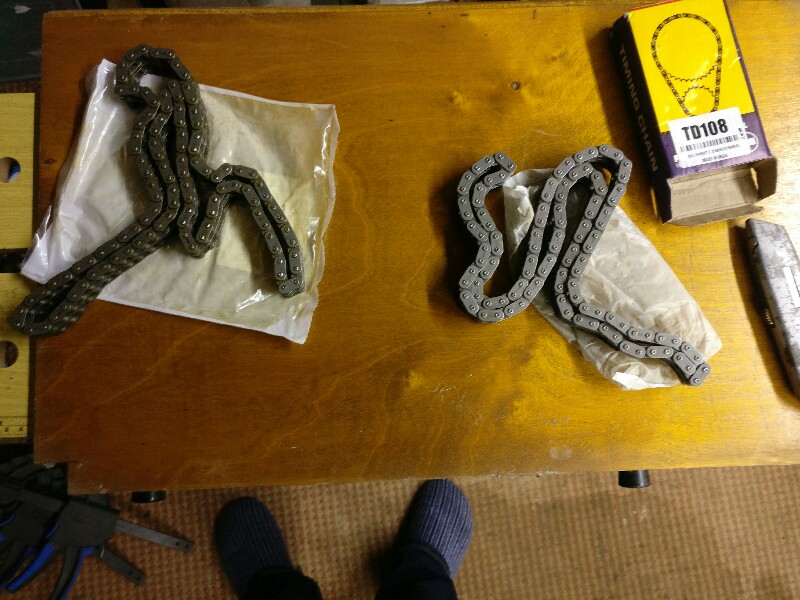

My new chain has been delivered from Jigsaw. I thought I'd write up my initial view of the 'better' chain against the Rolon. I'll try to be as objective as I can given my annoyance at all things Rolon!
The german chain is made by Wippermann. Through the clear wrapping I couldn't see a great deal of difference - have I just been suckered in by a supposedly better manufacturer.
I took the Wippermann chain out of the bag and the difference was quite apparent. The Rolon chain has far more slack in it, the rollers have more axial play on their spindles.
Obviously I can't tell any difference in the material specs or heat treatments etc.
Overall at the moment (no running under my belt) I'm more than happy to pay the premium. It gives me a far better peace of mind. Will the difference in the chain make any difference in the longevity of the chain? Who knows.
I'll keep you posted. I intend on taking the front engine cover off after about 500 miles for inspection / adjustment
