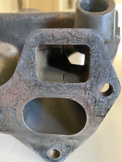

Malsprint wrote: Sat Feb 19, 2022 3:40 pm This looks like it could be the source of the leak.
Any advice on the best gasket to use and where to get it.
The manifold appears to be flat when inspecting with a straight edge. Hopefully I can get it to seal without skimming it. Plan B.
You can see from the pic that the leak is surely there!
You can also see the design deficiency, it really could do with an extra bolt to secure the area round the water gallery!
Since you can't have that, just have to make the best of what you have! Despite Clever's doom prophesy, i've NEVER had to skim a manifold yet. I concede the possibility of need, however and i've also junked several manifolds over the years for being eaten away by corrosion in this area. Which is pure and simple bad maintenance, run without antifreeze and that's what happens, not just to the manifold but inside the head too!
I mainly use the new style thick gaskets as those are what is easily available and have had no more problems with them than on the odd times i've had OE ones in stock. But it's become second nature to me to always add a ring of silicone sealer around the water gallery, having found it's no more than a 50/50 chance of getting a good seal with just the bare gasket, whichever sort I use. Since I do this professionally and time is money, I don't ever risk it! Plus I hate doing the same job twice!

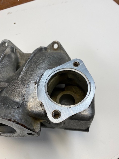

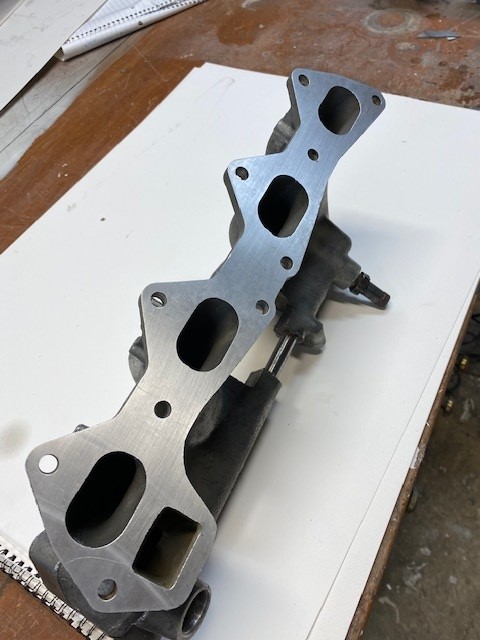

Finally refitted the manifold.
After reading the advice on here and given the degree of pitting around the water inlet passage I decided to have the sealing face machined. I got the thermostat face done while I was at it. Ridge Rimmer Machine shop in Arvada Colorado US (I know not much use for most people on this site) did a good job for $200. If I was in the UK I could probably picked up a good used one for less but not on this side of the pond.
I fitted it following the advice on here. So far no leaks.
