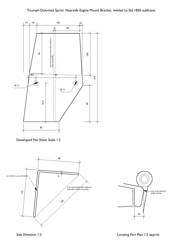

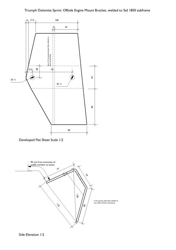

Looking at the Sprint frame in detail, it is quickly apparent that the frame is original an 1850 one adapted as the mount holes for 1850 engine are visible beneath the attached brackets. Hope the following drawings and photo's help...easy job I reckon ;-)

Thanks very much for taking the time and trouble to post the photos and drawings. I can now clearly see what is required to make the neccessary alterations to the 1850 subframe. I agree at face value it appears to be quite a straight forward job to make these changes. So only the enine mounts require adaptation everything else is the same - roll bar mounts steering rack etc? :D

yes, make the mounts in accordance with my drawings, weld them to an 1850 frame as shown and you have yourself a Sprint subframe.
Drawing available in pdf if you give me an e-mail address
