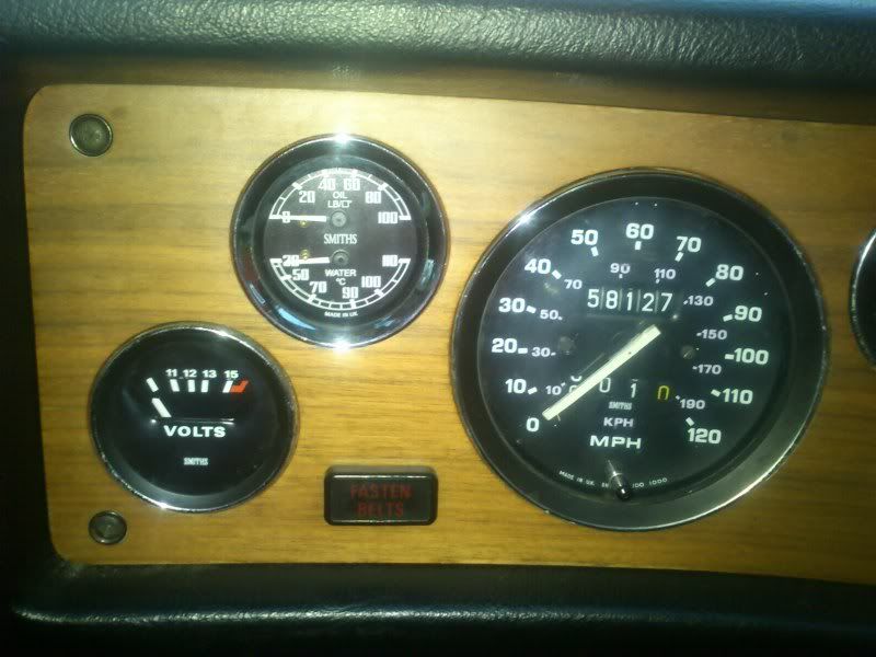

Quote:
Ooo! Oil pressure gauges!
It's now "fitted", in the loosest sense of the word, and is proving that I do actually have oil pressure, as opposed to the previous "ARGH I DON'T HAVE ANY OIL PRESSURE!" due to the light being on at 1,200rpm...!
Ignition on, oil lamp comes on. Crank it and it flickers, and as the engine catches it goes out. Pressure gauge showing a steady 20-30psi. (Picture below to prove this :) ). Driving about it springs up to 50psi, above 2krpm it's 60, above 3.5krpm about 70. I believe it was, therefore, the pressure switch!
Image Image
Yey!

So I was correct in suggesting that you should simply take out the bulb then? :P :lol:
70psi suggests to me that the oil pressure relief valve isn't blowing off soon enough, that's too much but hey, that should be easy enough to sort by fitting a slightly weaker spring.
