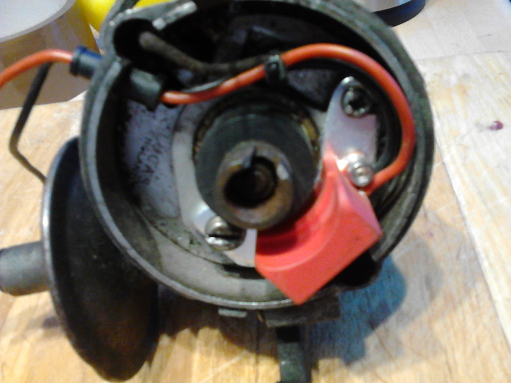

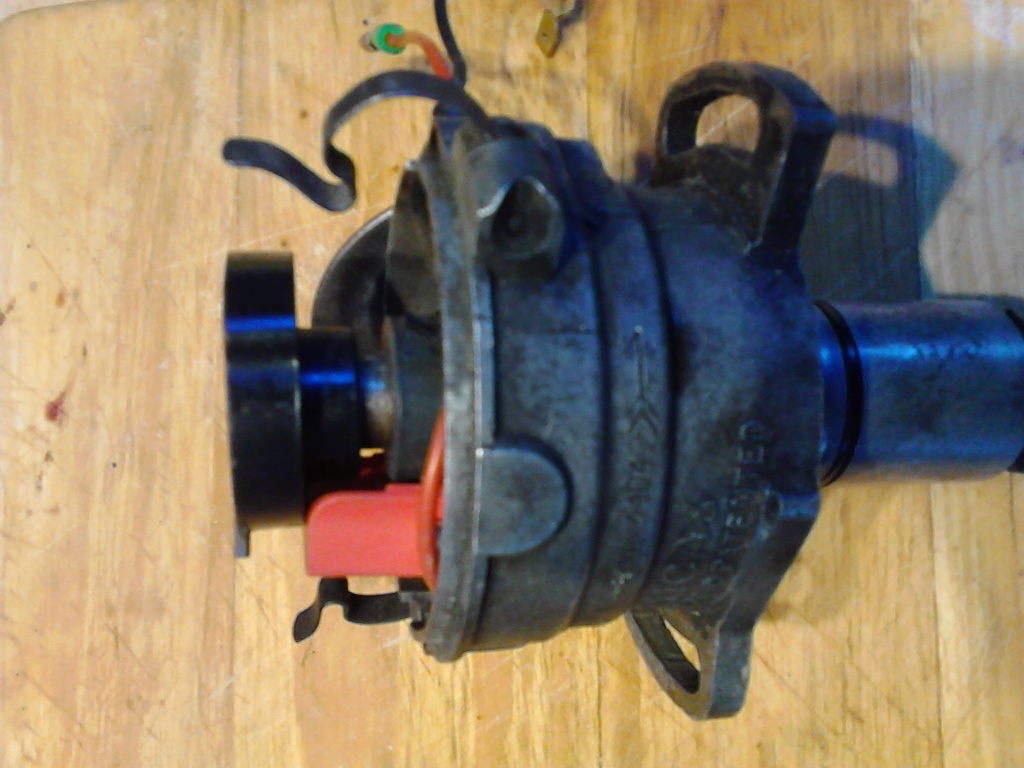

While I was looking for a spare set of points I found this distributor with an electronic ignition unit fitted. I have no recollection of where I came by it, could have been in a box of bits. So I thought, having time, I'd see if it works.
Problem is that the sender unit fouls the standard rotor arm, so the cap won't fit.
Now I seem to remember something about alternative rotor arms from the days when the standard ones were hard to find, but I can't find aught. I looked at the 45d4 one off the Herald, and that won't fit the shaft and the arm is too long. I could shorten the arm if that were the only problem, but I don't think increasing the size of the hole or reducing the shaft diameter are worth the effort.
So does anyone know an alternative rotor arm that fits on the shaft and won't foul the terminals?

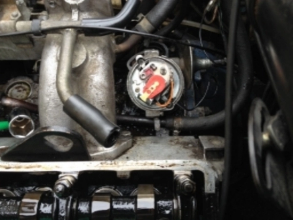

Bit more research turned up this image of a 44d4 in an 1850/TR7 with the arm I think I'm looking for.
Graham
Graham
- alt rotor arm.png (467.62 KiB) Viewed 1820 times
Re: unidentified electronic ignition needs different rotor arm
Is that from the Distributor Doctor? http://www.distributordoctor.com/ He sells red ones and his quality is usually excellent.
Aye,....
You will be needing a 45D cap to fit over the replacement 45D rotor arm.
If this is for a Sprint, then it will need side HT connections,
so look for an Austin Ambassador cap and ignition leads..
That's the one I use and it's from Simon BBC, so Accuspark which uses the 45D rotor arm or.....
If memory serves, this is for an Ambassador...

I think that rotor arm that's too long could be a 45d4. It turned out that the dissy with the EI unit in had a burr on the shaft that made it too tight, the dolomite and Herald ones weren't so tight a fit on, but the herald one took some getting off till I'd had at the shaft with a file.
I can see how the 45d4 one needs a different cap. But the 25d4 one seems fine under the standard sprint cap - with points in.
As to why the EI unit don't work, I can't say. I can't see that I had it 180 out of alignment cos it ran a bit. And I set the engine to TDC #1 with the rotor arm pointing at the locating lug and swapped the EI unit in so it was the same. Tried it in both positions the points one runs at, and tried the range of adjustment. I've compared the herald arm with the sprint one, and it seems a good match for length and alignment - the conductor is wider than the sprint's, and about centred the same.
But I couldn't get it running anything like right with the EI unit in, and I didn't like the way it did run. And not having any idea how advanced or retarded it was, I didn't feel safe with any of that. Whereas, I know I can get the points set to very close by eye and near cock-on with a meter before I even try to start the car. I might have put one in 180 out before now, ifn' I didn't look at the cam position, but it don't run at all like that.
Maybe the magnets driving the hall probe in the EI unit are off alignment with the cam lobes. But how would I check that before I get the car running well enough to use the strobe? And if that's so, how will the rotor arm line up with the cap terminals. I've looked at the arm I think is 45d4, and that seems to align with the sprint arm, just longer, and not be offset much.
So I think the fact that it wouldn't trigger the strobe suggests there's a problem with the unit or how it's wired.

I've measured the rotor arms I have. I measure the Sprint one at 21.6mm centre to edge, the 25d4 one from the Herald at 20.7mm, and the one I'm assuming is 45d4 at 27.6mm. However, they are measured from the centre wear marks made by the carbon brush on the conductor for the sprint and herald ones; where the 45d4 one hasn't been used and has no proper mark to go by.
The question is, whether the 36 thou extra gap between the herald rotor arm and the terminal posts in the sprint cap is enough to stop the EI unit generating a good spark at the plug? If it is, then how does it still spark well with the points driving the coil instead? And that's with everything else the same except the distributor body, i.e. same cap, same leads, same coil and wiring. When/if it stops raining, think I may put the Herald arm in with the points and go for a bit of a drive. I can then see if it affects anything at the higher end of the revs.
I've also thought about the issue, and while I don't mind the dolomite having a 45d4 cap (is one for the Lucas 45d in a Ford, which is cheaper, the same as the Ambassador one, as I assume?), the TR7 Sprint has to stay visually like standard. And I suspect there are others who'd be interested in an EI unit that keeps the car looking standard.
Graham
Graham
