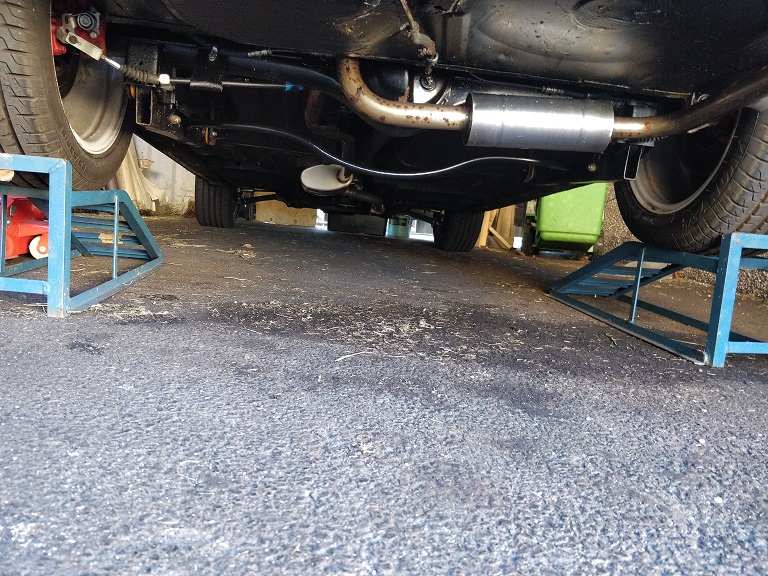

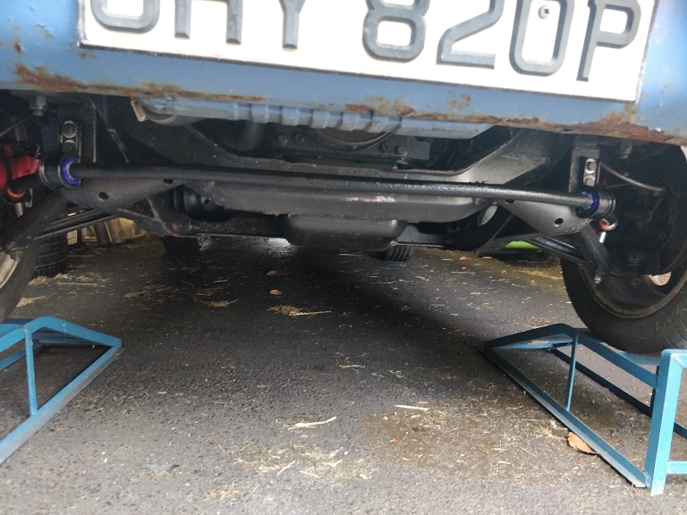

Hi All
I have decided to fit a front anti-roll bar, so I got a second had item off eBay for a cheap £15, but to my horror I discovered the cost of the brackets and end links would be over £230 quid! (On Rimmers it would be £60 for the brackets, £23 for the bar bushes and a frightening £148.80 for end link) so I was back on eBay.
Now, round two of eBay and I got another second-hand roll bar but this time with brackets for £26 (anyone in Aberdeen want a front anti roll bar?). Next I got some end links for a more reasonable £80 from Lemans-R Triumph spare via eBay and Superpror bushes for £19 from Robsport, again via eBay. So all in it was a easier to swallow £135, plus £40 for powder coating (If in Aberdeen I definitely recommend Finesse Coatings on Cotton street).
While on Rimmers website to find out the bolt sizes required I saw a rear Anti roll bar for £36 and thought, why not? After getting a bit carried away with hardware and £70 later, I had a rear anti roll bar and a bag of bolts, nuts and washers deliveried the next day. Now, have everything (so I think) ready to go, I paint the end links and the rear bar (it comes with no kind of coating I could make out) and get ready to fit the front roll bar. As I am sure you could guessed I have spotted I don’t have the spacers for the end links, so now I am stuck awaiting some steel to make then, so I moved onto the rear bar.
As per the photos it fitted very well, but the question is, since I will be making some spacers for the front, should I get some longer bolts and fit some spacers internally to the trailing arms? Hopefully that should be good at reinforcing the arms, I have seen people welding plates on top and I think this would be a better idea?
Hopefully update this soon with the front fitted and some trailing arm reinforcement. I really am interest to see what this does to the handling.
Regards
Barry

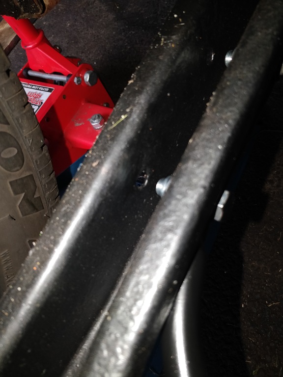

- Trailing - Fit spacers here?
- SM - 1500TC - Rear roll bar - Fitted trailing arm.jpg (114.83 KiB) Viewed 2946 times
- Fitted
- SM - 1500TC - Rear roll bar - Fitted.jpg (254.05 KiB) Viewed 2946 times
- To fit
- SM - 1500TC - Rear roll bar - To be fitted.jpg (154.2 KiB) Viewed 2946 times

You said you fitted a front anti roll bar but it looks like a rear one.
I fitted a rear one to my 1300 too.

There is a bolt hole through both sides of the rear trailing arm purely to avoid there being a pair of handed parts; having both bolt holes means the part is universal to both sides. The rear anti-roll bar is only intended to bolt through the inner wall of the trailing arm; it would make it significantly stiffer, probably too stiff, were it bolted through both walls with or without a spacer...they reduced the wire gauge used to make the rear ARB very early on as it was too stiff...

I think you need to re-read what I posted!
The front Anti-roll bar is awaiting some spacers, so I fitted the rear in the mean time.

What Alun said ^^^^^^^
The extra holes in the trailing arm are purely a production economy measure.
I'd also question the usefulness of stiffening the trailing arm at this point as it's nowhere near where they habitually fail, which is just at the curve where the arm kicks up to the back axle fitting bush. Again, as Alun said, stiffening it here could likely increase the strain on the weakest point (which is elsewhere) and cause an even more premature failure.
I don't actually want to think about the effects on handling of your current situation with a rear ARB fitted and no front one! Having a front ARB on a Dolomite shaped car is, IMO, an absolute necessity, it gets rid of a whole heap of roly-poly-ness and turn in understeer. The effects of the rear bar are a lot more subjective, some people think it works better without one (including the works BTCC team who substituted a piece of piano wire for the stock ARB, they couldn't just leave it off for homologation reasons)
On my Carledo, i've added one and left it on, the car seems a tad more predictable near the limit with it. But i've messed with nearly all the vital figures on that car, weight, C of G, ride height, spring rates, shocker spec, rear roll centre, camber, castor, tyre width, diameter and aspect ratio, bushing specs etc, my car isn't a good guide!
On the front spacers, It could be time for the club to buy a couple of metres of 5/16" tube and market them! Seems anyone buying a used bar to upgrade an earlier or low spec model needs them! Plus all the ones mislaid during restoration. These and the bonnet hinge catch plates seem to be most often lost (unobtanium) parts in a resto, with wiring loom clips a close 3rd!

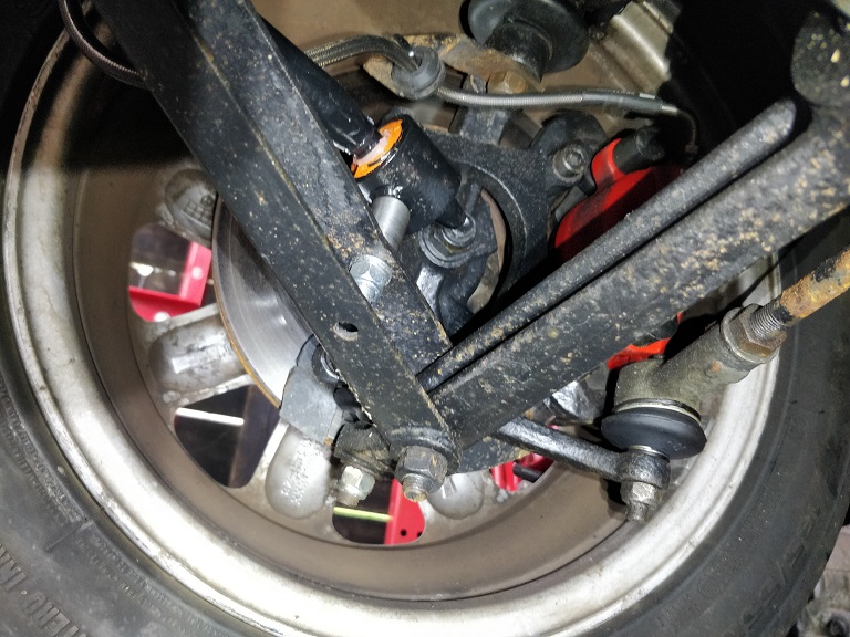

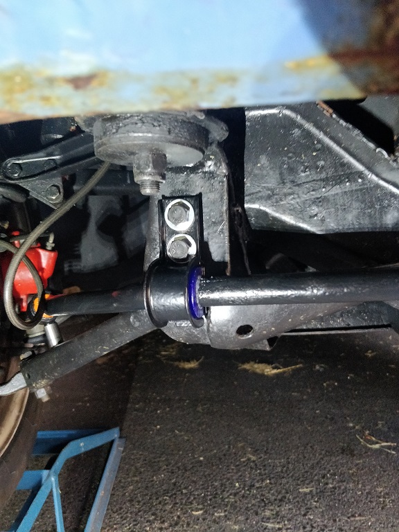

Hi All
Well I finally got the steel for my spacers so today I fitted my front anti roll bar. Getting the bar clamp bolts in was a bit of a faff but it not much hassle. Not had time to test drive it yet, but I have a 25 mile drive on Sunday to a car show with a good few twisty roads so I will hopefully be able to give it a good test!
** The picture of the spacer on top is incorrect, it should be in the C channel as shown
Enjoy some picks and ignore my rusty front!
Regards
Barry
Regards
Barry
- CORRECT FITTING
- SM - 1500TC - Front roll bar - End line CORRECT.jpg (151.82 KiB) Viewed 2729 times
- INCORRECT FITTING
- SM - 1500TC - Front roll bar - End line.jpg (184.28 KiB) Viewed 2781 times
- bar clamp
- SM - 1500TC - Front roll bar - Clamp.jpg (177.47 KiB) Viewed 2781 times
- Fitted
- SM - 1500TC - Front roll bar - Fitted.jpg (175.43 KiB) Viewed 2781 times

I don't want to tell you how to suck eggs but the spacers on antiroll bar go inbetween the channel on the tie bar thus bringing the end of the tie bar down, somebody else might be able to post a picture,
Re: 1975 1500TC – Anti roll bars
There is a good illustration in the Haynes 1500TC and HL manual on page 158 - "front anti-roll bar attachments"
