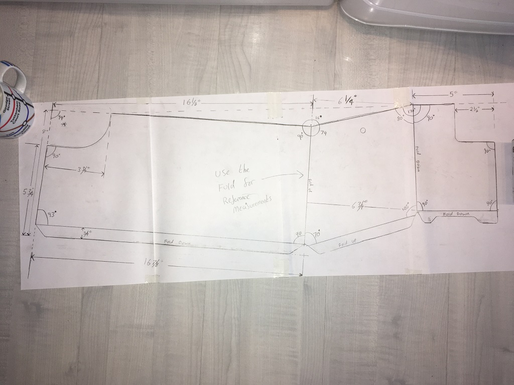

I am in the process of rebuilding my front parcel shelf and have made some drawings with the measurements.
Hope this is of use to other members who might be attempting this job.
Darrell
Darrell
- RH Shelf draw and part 1024.jpg (196.87 KiB) Viewed 2884 times
- LH Shelf new 1024.jpg (191.08 KiB) Viewed 2884 times
- Centre Shelf 1024.jpg (208.31 KiB) Viewed 2884 times

Can you make one for me?
Great drawings very useful, thanks for posting.
- Posts: 192
- Joined: Thu May 10, 2012 8:08 pm
Re: Front parcel shelf
Great stuff, well done for going to the trouble of posting. Hopefully, your drawings will prove useful to many folks.

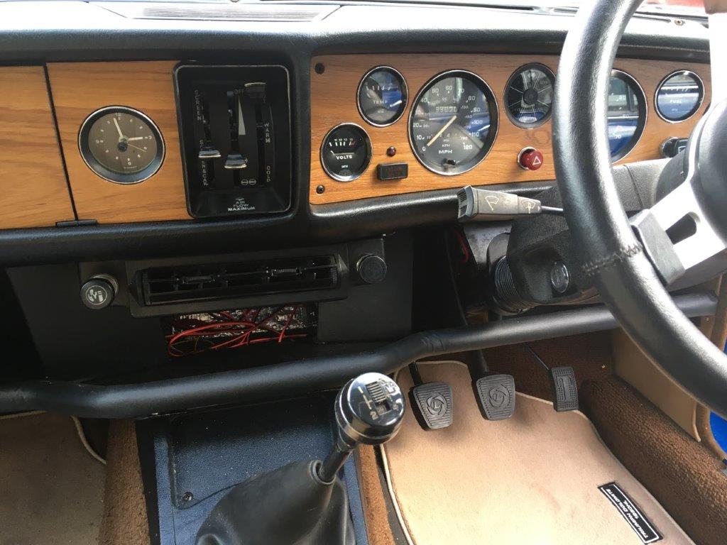

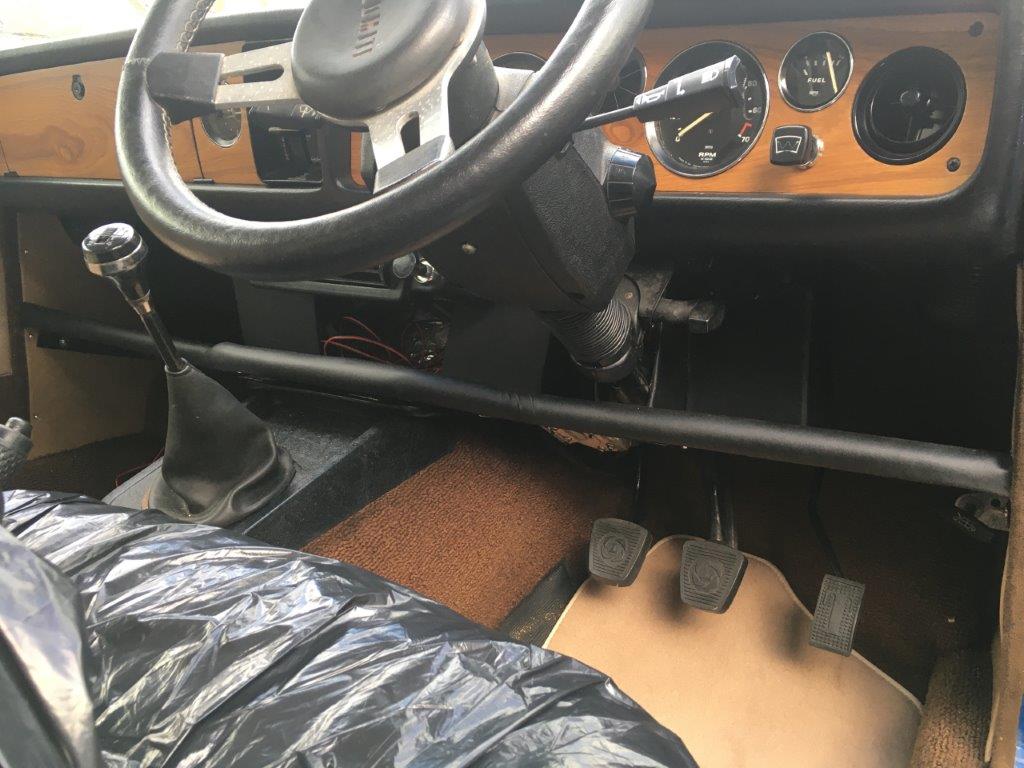

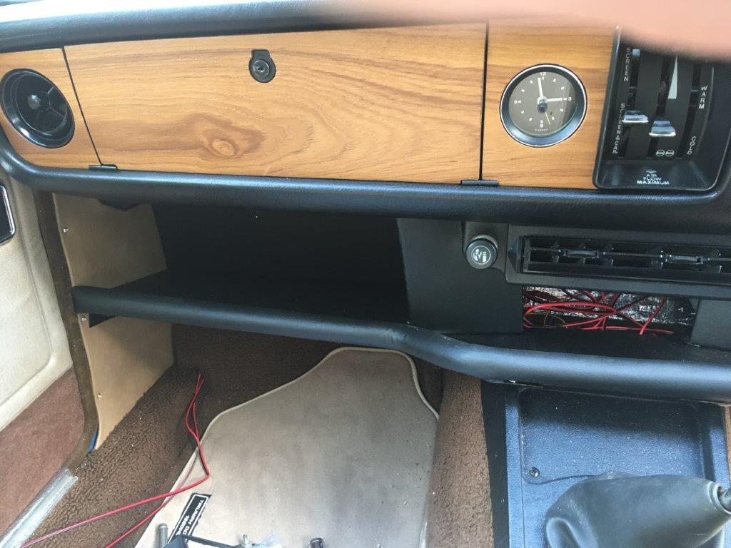

Hi
Thought I would let you see the finished result in the car.
It is a vast improvement on the original that was looking very tired.
- Before going in.jpg (339.62 KiB) Viewed 2756 times
- IMG_1495.jpg (171.78 KiB) Viewed 2767 times
- IMG_1498.jpg (117.6 KiB) Viewed 2767 times
- IMG_1497.jpg (108.32 KiB) Viewed 2767 times
- IMG_1492.jpg (106.83 KiB) Viewed 2767 times
- IMG_1491.jpg (115.78 KiB) Viewed 2767 times

Nice job,is that mill board ? did you have any touble bending it
Yes
That is a good job Darrell.
I have had a go at this using correx board, which has turned out okay but
what I have struggled with is recovering the rail and have yet to find a solution.
Delft blue is a smart colour.
Is that a 13” steering wheel?
I am going to try one but am fitting a 3.25 turns rack and 185 section tyres.....
Ian
Ian
Hinew to this wrote: ↑Sat Feb 06, 2021 4:38 pm Nice job,is that mill board ? did you have any touble bending it
No it is just hardboard, I covered it with Vinyl and re-enforced the corners where it was bent,
Which seems to work
To bend it backwards I made a score with a Stanley Knife at the front and bent over a straight edge,
to bend it forwards, again I scored the front with a Stanley blade but turned the blade sideways and did it again to make a wider score, then again placed over a straight edge and bend,
Once you get the bend going I then covered it with vinyl, then when fully stuck heat up and continue the bend, I then re-enforced the bend with right angle posts
The lower bends which are not right angles that meet the base I ran a bead of glue to strengthen them

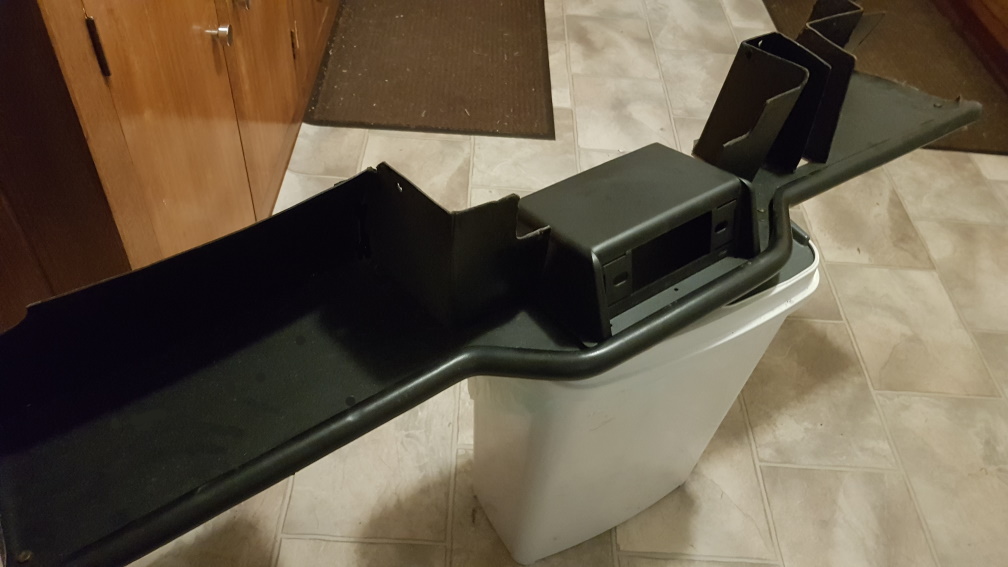

Hi all.
My first post (from Australia) and it's ref. the parcel shelf and my particular solution.
I had the same as everyone problem; the parcel shelf had been butchered by previous owners removing and shoving back in, plus severe folding and warping from moisture absorbtion over the years. Surprised and frustrated that such a commonly needed and obviously fragile item does not have a readily available remanufactured replacement, I did the following:
1) Removed all the split rivets and traced and cut a new base in 2mm MDF (original was masonite, which would have done as well, but MDF was cheaper on the day), including rivetand bolt location holes. The new base was covered in a thin black vinyl similar to the rear parcel shelf material
2) Used a technique of a Ewe-Tube vintage radio restorer who, when faced with warped or damaged rear panels (usually made of masonite or the same lousy carboardy stuff the parcel shelf is made of) would soak the item in a water/PVC glue mix for a few hours, then press the item between two layers of clingwrap, clamped tightly between two boards and let it sit for a few days to a week. With the cardboard part of the tray now dead flat and rigid, it was easy enough to fold along the original seams. Sprayed the whole with a semigloss black.
3) Soaked a large number of split rivets in a mild acidic solution to etch the stainless steel and then after washing, dipped them in bueing mix, to turn them black
4) re-assembled rail, new vinyl covered base and rejuvenated shaped cardboard original backing.
The radio cutout was a problem as sometime in the past it had been cut overly large. An aftermarket under dash single DIN radio holder in black plastic flipped upside down and trimmed to fit beneath the heater vent sits almost perfecttly in the hole and was bolted to the parcel shelf using existing support bar bolt holes.
Maybe this will help someone
