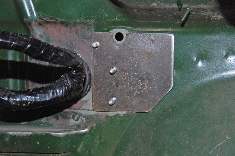

Imagine this:
bolted the other side of the bulkhead on Mark's photo using the existing throttle mount bolts on the lower two holes and a new n & b through the top hole.
View from engine bay:

I took the attached photo on the plate which I fitted to my restoration, yesterday. As you can see I have fabricated a plate – the lighter green (undercoat colour) which fits under the accelerator pedal bracket but I have also fabricated a plate which fits on the other side and which sits under the firewall padding.
Can somebody tell me what the hole is for to the left of where the accelerator cable passes through?
If it is a spare hole then I would be inclined to make a bigger plate and use that as a third mounting point, in order if nothing else to transfer the forces further across the firewall.
It would be better though to make the plate larger to the right of the picture in order to transfer the force over the seam – cannot be seen in this view, where the inside wheel arch/guard is attached to this whole pressing. The seam on the engine side would help to absorb some of the forces generated when the pedal is pushed.
This bulkhead is not flat of course as can be better seen in the shot posted by Alan.
I shall pull my pedal off again I think, and make up another cardboard template and then go for a scavenge in the scrap metal bin. I used to make hacksaw blades, great for cutting metal!!!!! Great for making little plates like this
Of course if that is a spare hole (not one in Alan’s picture) then I will need to plug it with yet another grommet if it is not serving some useful purpose.

Re: Bulkhead Weakness Solution
#24 Post by DoloWIGHTY »
Had a close look at the bulkhead around the pedal on my own car, incredibly difficult to see I feel, so what I did was stick my mobile phone down there and take a picture:
Certainly evidence of something occurring - what I am unsure though.
With the aide of an attractive assistant I got her to operated the pedal whilst I carefully watched this area, I saw no flexing whatsoever throughout the entire throttle range.
I just cannot see what is on the other side (inside of the car) as the parcel shelf is obscuring it.
I learnt that the bulkhead pad doesn't need trimming if I was to fit this bracket - which if the club does press ahead in making I shall purchase.

Alan
You have done extraordinarily well to get that photo. I have visions of you hanging upside down off the roof off your shed (??) wriggling past everything in the engine bay. Well done. I have fabricated a plate to fit that shape - oh please do not ask me to photograph it in position, that sits on that side of the firewall. An attractive assistant - and you perhaps hanging upside down with a camera? Oh dear, my mind boggles.
But that is the cracking to which this thread refers.
But as I say I think I will fabricate a much larger plate on the other side so that it reaches over the inner wheel guard seen in your photo.
And my spare hole? Hmmm. A grommet I think will be used to fill the hole for as soon as put a bolt through it I am sure I will find something goes through there. The previous owner fitted an oil gauge, maybe he took the pressure pipe through here.

Posts: 13569
#27 Post by xvivalve »
Robert, I suspect your car was once automatic, that third hole is about where the nut and bolt pass through the plate.
Alan, you may find your pedal can move side to side. In doing so, if it moves toward the off side it will hit the inner arch before the throttle is fully open.
What gives the auto plate its strength is the side peening.
