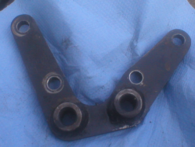

- Posts: 2338
Re: 1500hl woes
Hi Alan, Is this another part of what you need ? I thought the bracket bolted straight onto the gearbox, but a friend says this is part of it as well. It is made of 1/4 thick steel so its a pretty substantial bit of metal work. Much stronger than the one on my 1850. I can't find this bit in the 1981 Dolomite Parts List btw.
Failing that does anyone recognise what this is please.
Cheers All,
Cheers All,
- dolly bracket quarter inch.jpg (68.23 KiB) Viewed 694 times
- Posts: 1218
- Location: Bristol
Re: 1500hl woes
I think it is part number 157691 and is used on the 1300, 1500 & 1500HL non O/D Manual cars to connect the gearbox to the rear mount.

Re: 1500hl woes
Just to let everyone know that this did indeed sort out the drone a d vibration. The club came to my rescue again. I also fitted a new stain!ESS downpipe which necessitated a new manifold. Another case where one job led to another.
