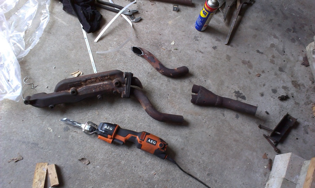

I finally went for the tough way out, not easy though!
What do recommend to get the manifold look as good as new?
And do you have any suggestions for some modifications which could make life easier with the manifold and manifold/downpipe screws?

Re: Sprint manifold+downpipe removal
First you need a new downpipe......
Think we have a decent one if you would like to buy it.
Jeroen may have one that is cheaper to ship though. Postage from the UK may be dear.
You need to use studs (copper plated if possible) and brass nuts with a plain and spring washer on the flange joint and not bolts.
The manifold never looks that good. You can try some high temperature paint. I leave mine natural.
