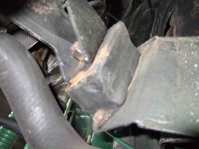

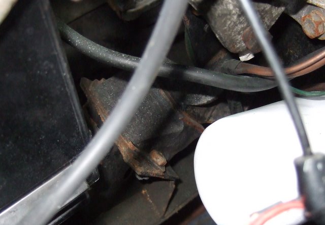

Ok, I have tried to take a couple of photos, but they're not the easiest things to photograph!
Nearside one from above: Offside one from below: I know they're not the best photos, but Is that amount of "flex" in the rubber normal?
Re: Engine mountings
That's pretty much the shape they're meant to be. There are no restrictor brackets though, which would allow excess movement and also lower the position of the engine a little. (I mentioned those in that other engine mount thread and it turned out that Sprints didn't have them but as your engine mounts are the same as 1850 ones, it's possible that they ought to be present on the OHV models).
No it isn't. It is what is sold as a non-o/d manual gearbox mount, it's not correct but can be attacked with a grinder to fit that job. The points go to Howard who correctly spots a spitfire engine mount. Dolomite O/D and auto gearbox mounts are both very different.1300dolly wrote:That lower pic is a rear or gearbox mount
The lower pics IS a rear mount (andotehr applications) because the original type is NLA yes it does need trimming with a grinder same as if fitting it to a 1300FWD but it still is a rear mount, as tinman says the auto/ manual box mounts are different, infact very diferent with the aout ,ount being NLA.
The 13/500 and 1850 mounts are different (didnt i already say that?) although they look the same, as i said i dont know if the 1850 is suitable because i have always used the correct one as listed for the 1500 as as these are still avalible why use a different one.
P.s the mount in that pic is marshmellowed!
'1300dolly' is bang on correct. Dolomite 1300/1500 front engine mounts look identical but the rubber in the 1850 mounts is much softer, I presume because the engine is a smoother unit.
If you fit 1850 mounts (as I did once to my 1500), you will found that the engine will move from side-to-side by quite a bit.
R
R
