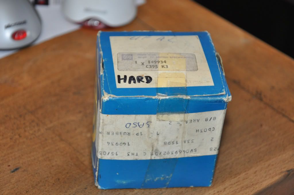

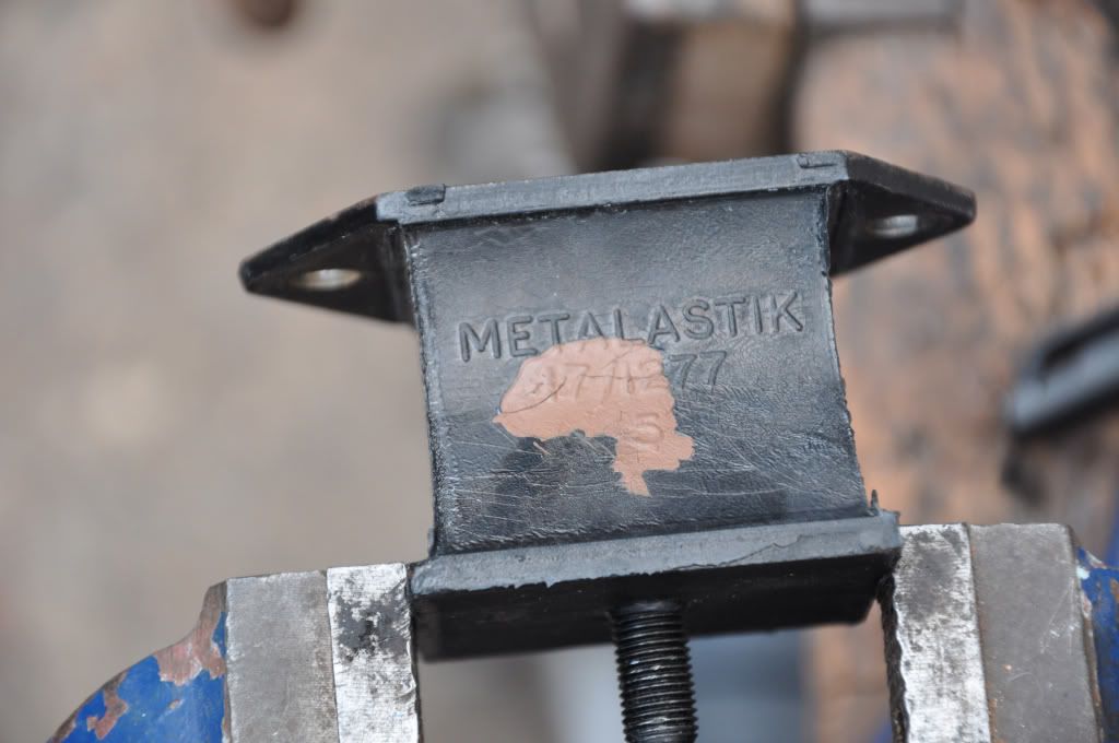

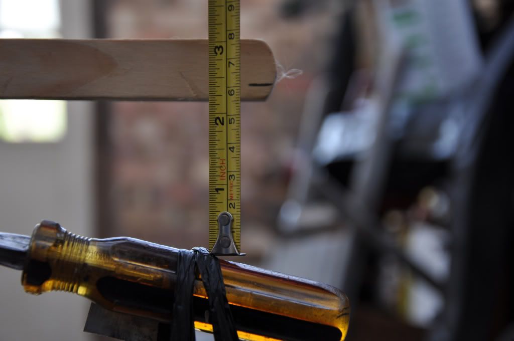

'Ere we go then. This is what I got from Mick Dolphin, HARD is his writing and he ought to know the difference as he had both in stock to compare.

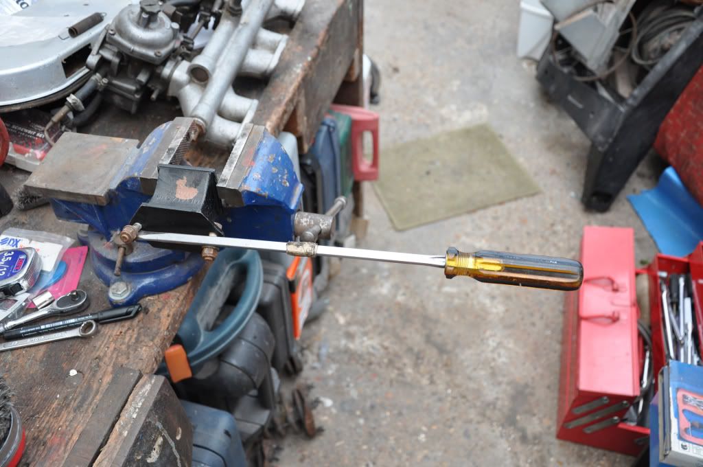

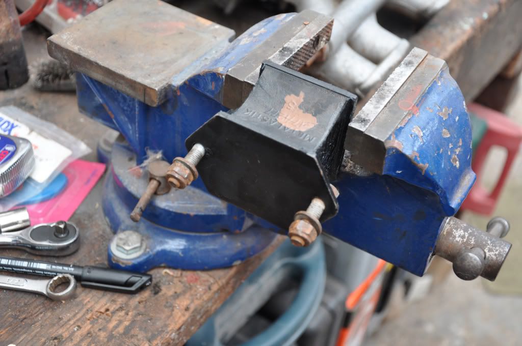

Mounted up in a vice with a clear brown splodge of paint.

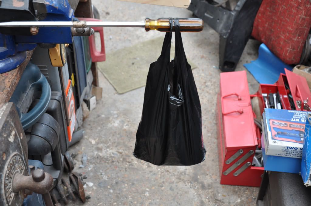

Add two bolts from the bucket

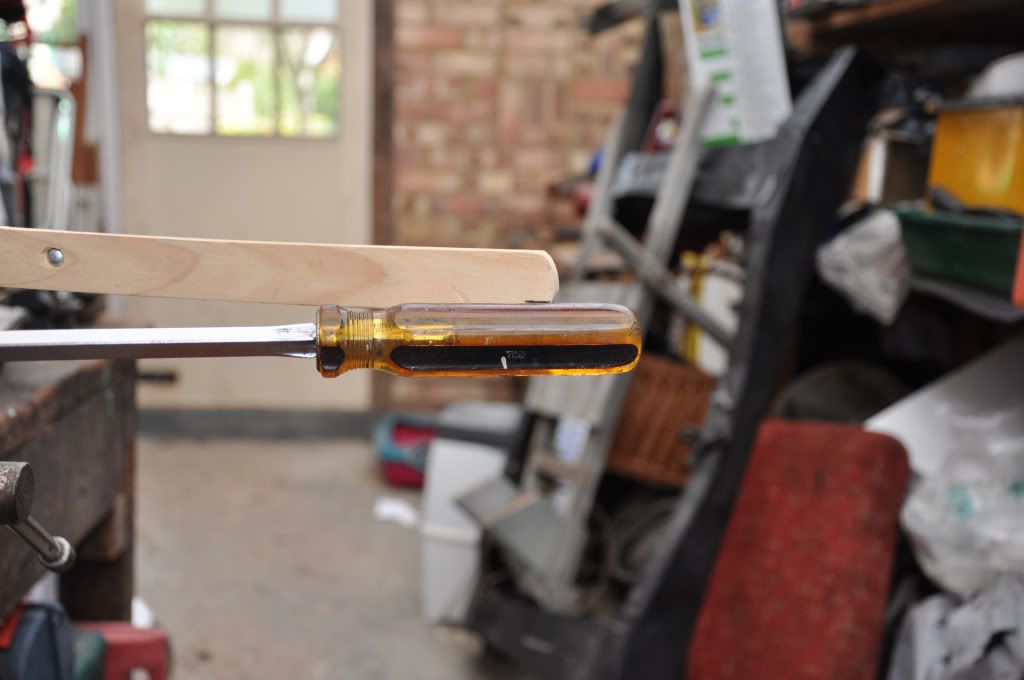

a long screwdriver
and a stick for a pointer.
Measure 12 inches from the centre of the bush
and make a mark
also mark the stick.
2 tins of beans and a couple of bolts & washers reads exactly 1kg on the kitchen scales.

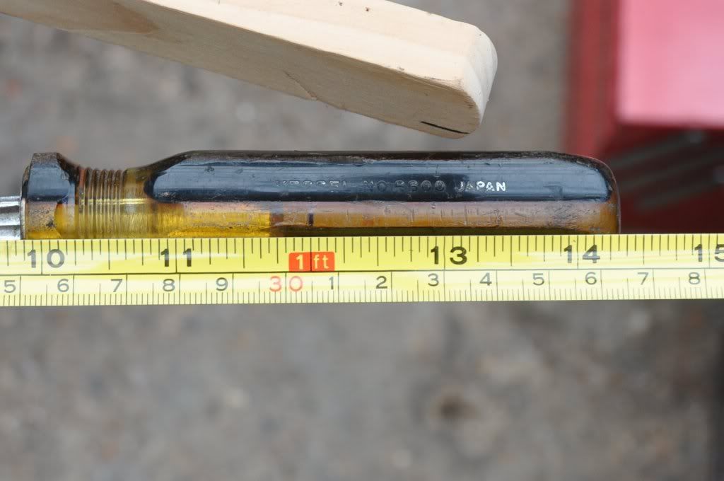

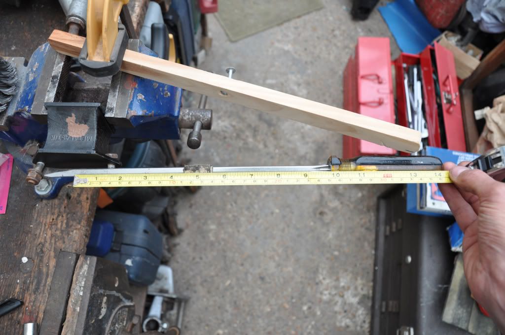

and the deflection is 19mm
Easy. If you can replicate this with your stock JPB & Cheesy hopefully soft ones will show a significantly different twist. I'll be down at Wins later this week & I'll see what he has for comparison.

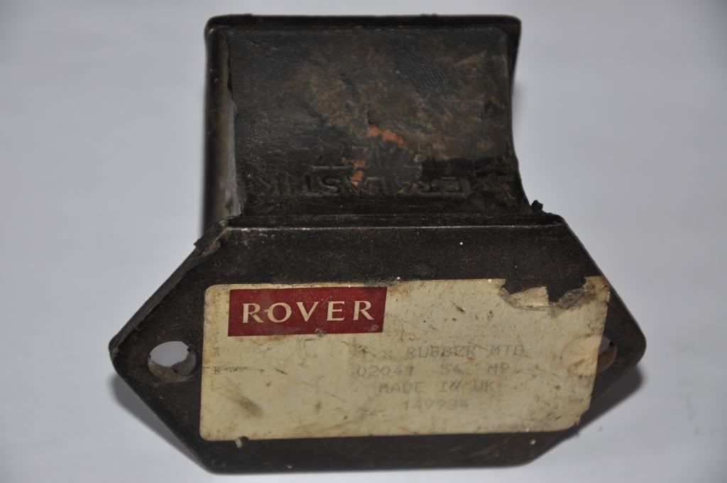

interestingly that the hard ones are 149934 which is the 1500 mount. john for a real comparision it would be better for Julian to test your mounts.

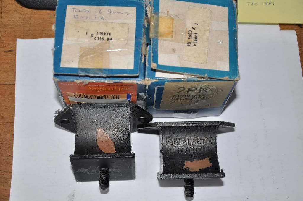

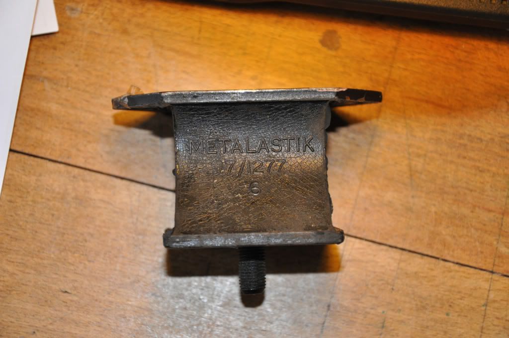

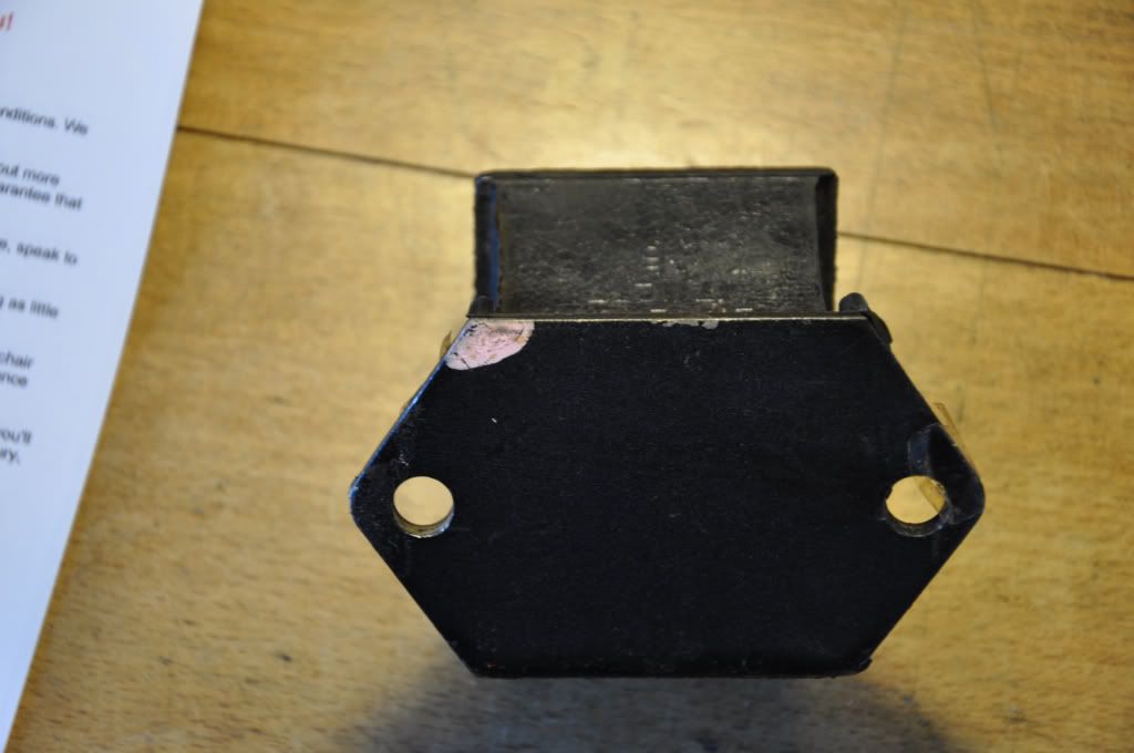

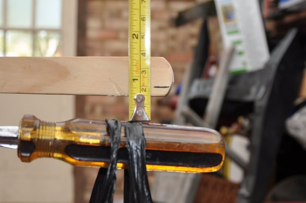

At Wins yesterday signing over another large slice of my soul for GT6 parts and he had one Metalastik in stock so I nabbed it for the science.
Here's the only paint mark on it.
And the result is....
So as hoped for markedly different. It's pointless trying to describe how twistable these are in hand, until we build confidence in the coloured markings this test is the way to identify any you have in stock. Even if the marks did go on in the factory (which we have no way of proving) we have no way to know they used colours consistently, they may have simply used any two colours that came to hand to differentiate a days batches.

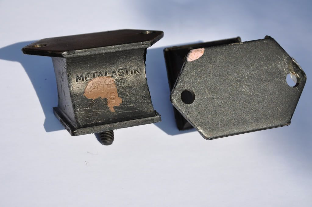

Here's both in daylight hopefully go give a better colour rendition.
To my eyes and those of Mrs Weevil the brown is just brown, no ish-ness about it. The other I see as pink and Mrs Weevil calls peach.
Wins had some pattern ones in stock that felt closer to the hard than the soft but he had no matched pairs.
NB: All results are provisional pending independent validation at test site B. Which may of course throw a spanner in the works if the paint marks are reliable and red is a 3rd grade. The more people can repeat the test the bigger our sample size and the better chance we have of making sense of it.

The remains of the paint on this one matches the brown on the other 3 so I am starting to believe the colour splodge may have more than passing significance. All three of these are concrete hard like the first one I tested. But what does red mean :scratchin: :?:
