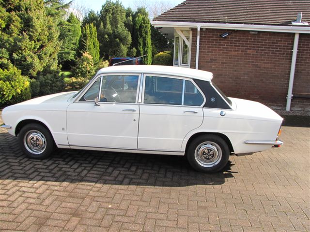

Very smart James, you cant beet an early Dolomite
This my auto. Complete with lower trim below the doors, that some people say were not on as standard?
- IMG_1039_1.JPG (78.43 KiB) Viewed 2640 times
NOW A CLUB MEMBER 2017057
- Posts: 7245
Re: DTR - Project Recommission 1972 'Dolomite' Manual
The sill moulding is ok on an early car Tony, the late addition, 76 on, which you don't have, is the ally rubbing strips at the lower door swage line! The car looks fine to me, respect sir!
