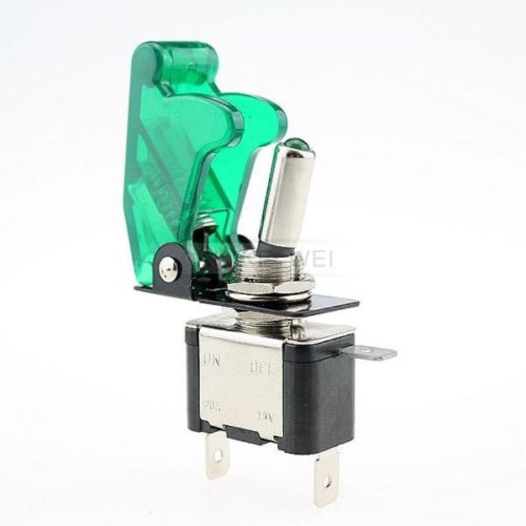

I'd like to wire in an indicator light to tell me when the fan is running, I'll get an LED and wire it into the power terminal to the fan that should flick on and off as the fan comes on and off.

I used a led toggle swtich, lights up when the fan is on, and I can swtich on the fan if I want to with the ign
off, the cover acts as a failsafe to revert back to ign temp switching, mounted on the fog light swtich bracket.

Yep, already got the revotec fan controller switch on there.
