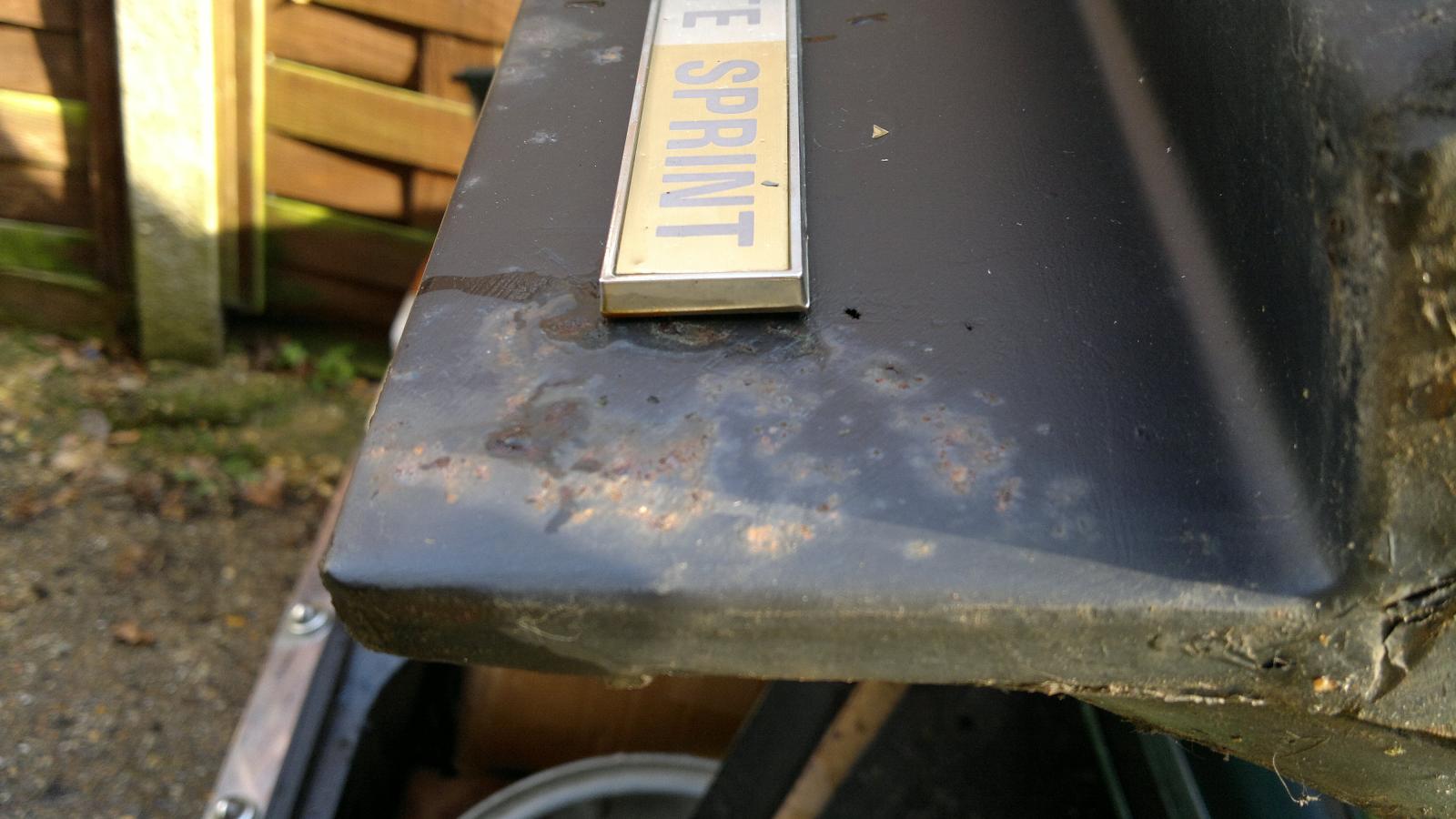

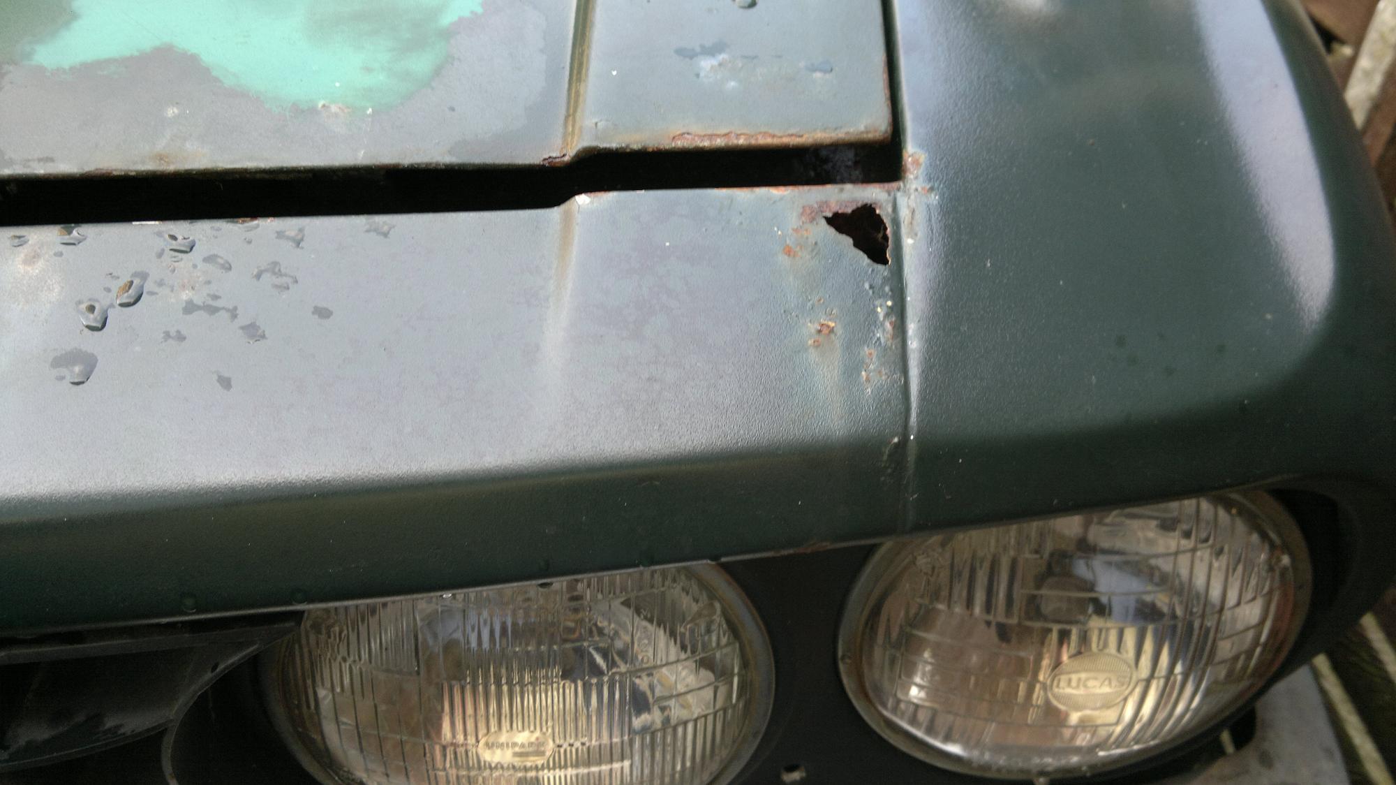

I have taken pictures of the main bad rust areas, I have poked it with a screwdriver and it appears to be surface mainly.
On the surface rust , do I simply wire brush it , clean it , treat it , then paint it?
On the hole in the front panel , what would anyone recommend?
