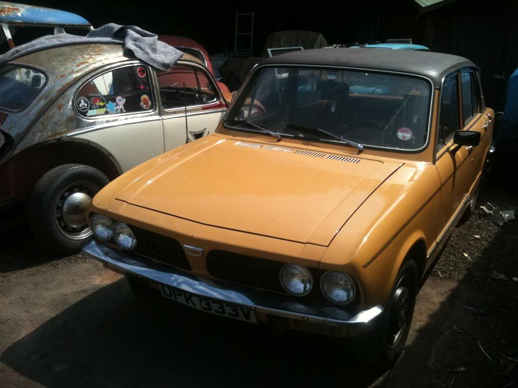

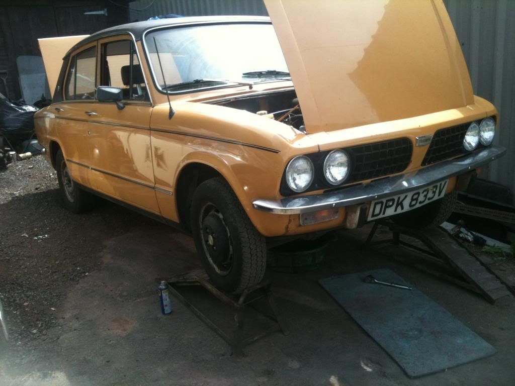

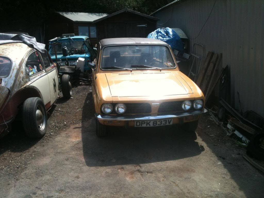

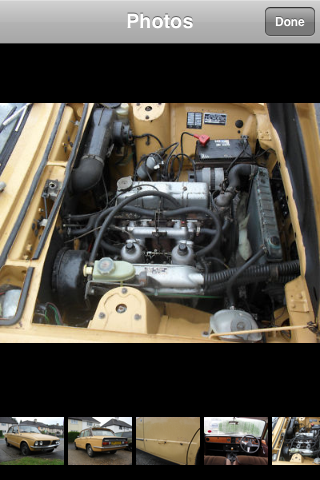

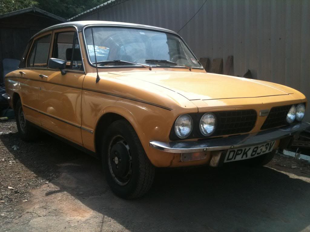

Right, finally got some pictures, will be taking more eventually but sorting out the problems have taken priority...
For some reason using photobucket has cropped the edges of the photos but you can still see the majority of it.
Preparing for the clutch to changed:

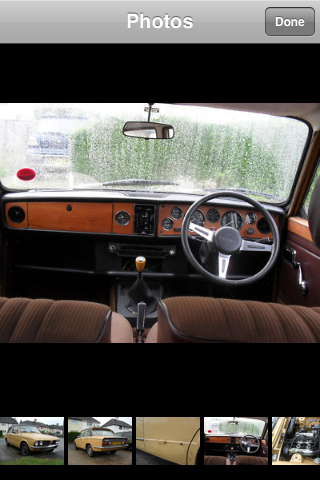

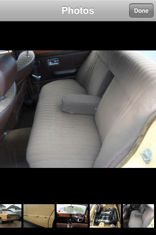

And a couple from the eBay listing:

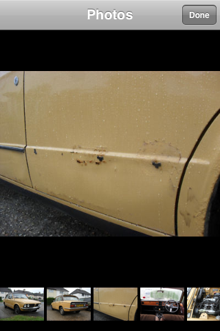

And a little cosmetic damage which will hopefully soon be sorted, don't suppose anyone knows the British Standard/RAL code for Sandglow? Because we got a matching colour for a Beetle recently and it was dirt cheap (like £70 for 5 litres!):

That looks pretty sound really. Tell me; how can you haggle over the car not having any duty in the screen? Presumably the seller declared that at the time? :lol: :wink:

I spy an Imp in them pictures! Yes please!
I will have one of them one day, preferably a Californian/Stiletto/Chamois Coupe variant, he says, not being able to tell which one that is.

Oli_88 wrote:I spy an Imp in them pictures! Yes please!
As far as I know it is just a Hillman Imp, I was toying with the idea of buying it off my boss before I bought the Dolly but it really is close to scrapworthy, I may buy one someday...
