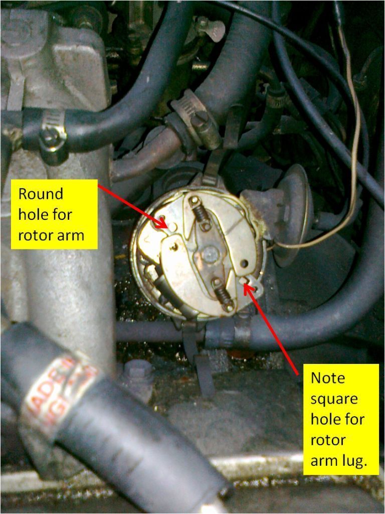

Remove the distributor cap.
1850 points pic 1.jpg (130.57 KiB) Viewed 1575 times

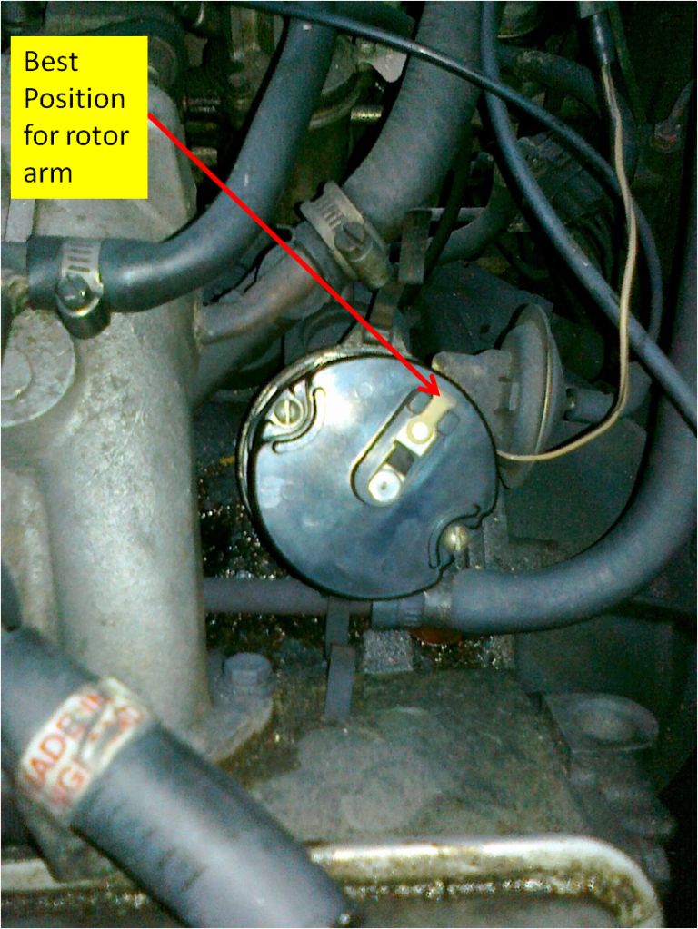

Rotate the engine to get the rotor arm roughly North-east. Note the offset location holes for the rotor arm.

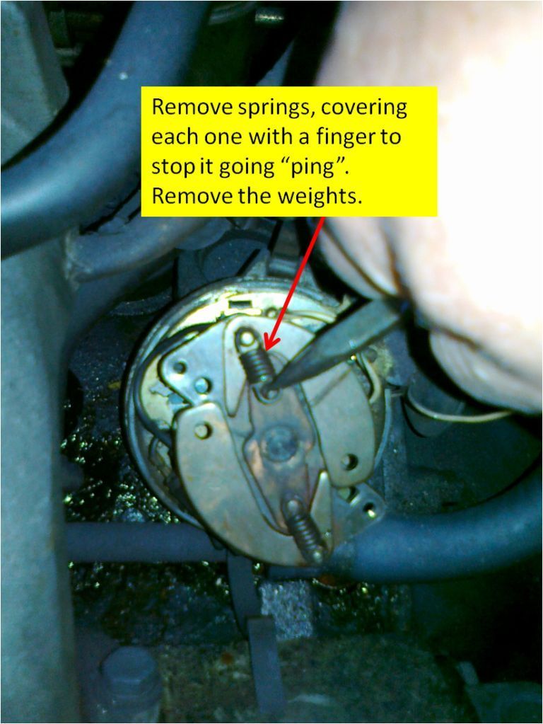

Remove the springs.
1850 points pic 3.jpg (104.7 KiB) Viewed 1573 times
Clean it off.
