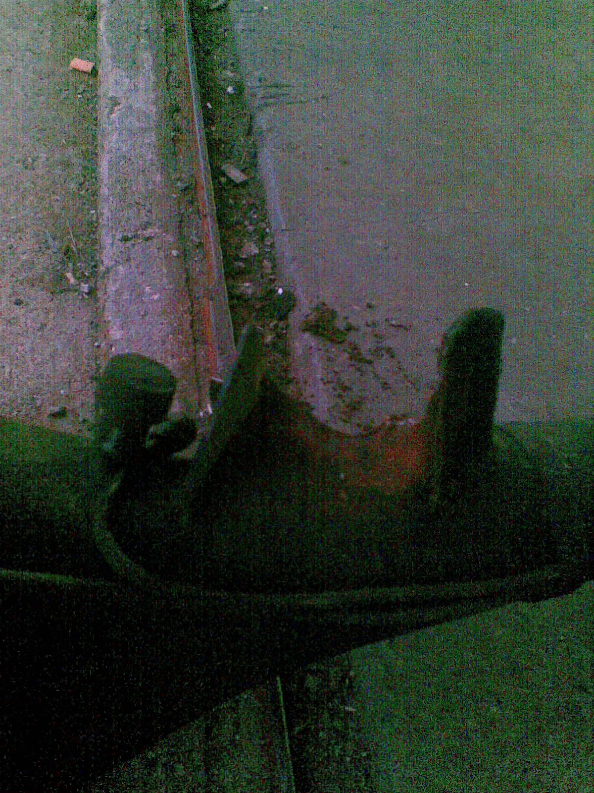

Small tip, don't polybush both ends of the rear trailing arms, they need some lateral movement, otherwise they crack. Never good!

Solid advice there. The inner end (as in; the end that's attached to the car) would be better off being rubber, though to prevent too much lateral movement there, you can use the solid bushes intended for the axle end in those locations instead of the voided bushes. Polys at the axle end shouldn't be too hard as the arm needs to be able to move relative to the pivot point and to the axle, the latter to a much lesser extent.
Come to think of it, the only places at the back end of mine that were treated to polys were the bushes at the axle ends of the upper arms. But even fitting standard rubber everywhere is bound to make a noticeable difference if the car hasn't had any replacements for a while.

Fully poly'd

:shock: Ouch!
