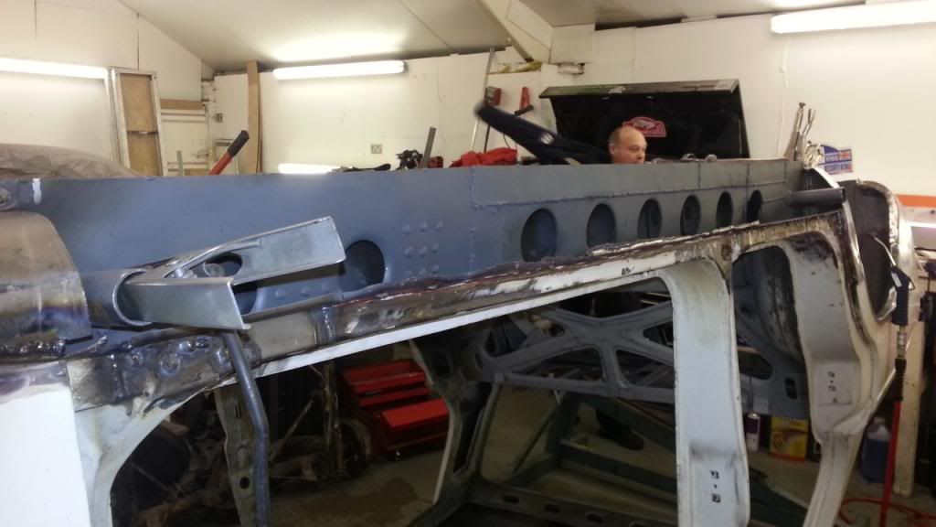

#6 Post by lazeruspete »
i guess it depends what you find when you cut it open.
if you really want to go bonkers (like me) you can do it like this
this was necessary on my shell but it may not be on yours! (lets hope so :) )
viewtopic.php?f=19&t=23031
