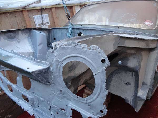

I have nearly finished the plating and strengthening the front inner wings and passenger floor section. The more I think I have finished a section that I find another weak rust affected area, but after 50 years I suppose I am not surprised. A few more areas need to be done and then I can tidy the weld bumps up with trusty angle grinder, seal with tiger seal and paint white. Managed to soak inner sill with Dinatrol and then weld strengthening plates to the centre sill section which had rotted through at the bottom. Not pretty by any means but it will not be seen when outer sill is assembled and is very strong. While doing this I managed to build a 'box-section' supported by the door pillar which I will use as a jacking position for front wheels. I will do the same to the drivers side before fitting outer sill. I have added a location on the rear subframe for removing back wheels when it was off the car.
I have spent some time de-rusting the front subframe and attached assemblies. This was done with rotary wire bush in angle grinder or a pedestal drill on full speed for the smaller bits. Jenolite was used before 2 coats of Zinc paint and one top coat of Chassis Black. Not the perfect of finishes but they are on the underside and should not rust again.
My next goal is to assemble the front subframe to the car with the wheels on so I push it out of the garage and fit bonnet, new wings and doors with new lower bottoms to get the gaps right and then strip down and finish - sounds easy.................

Painted the front engine section, inner wing section and all underneath up to rear subframe in zinc primer. When dry I will tidy seams up with sealant and paint all with white paint to match completed rear underside.

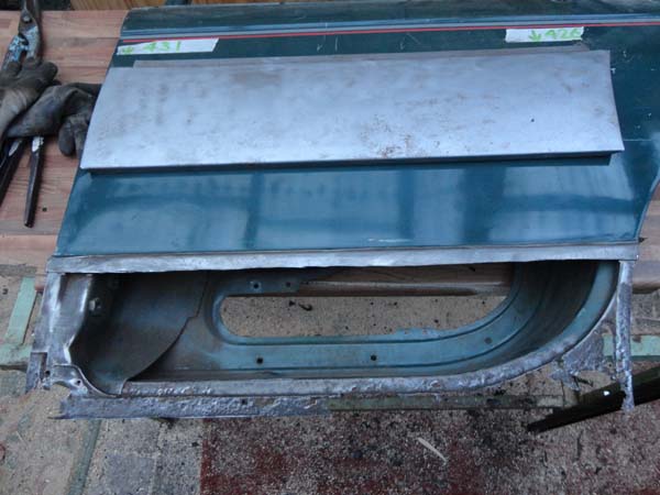

Decided today that I could not weld the lower part of the door to the new bottom door outer due to rust. All 4 doors are in the same condition so I have decided to cut rot away and make new inner plate attached to door bottom so new part can be closed over it and them weld new part to door. Best look at photos as I do not think that makes any sense!!!!
The end result looks quite good and once filled and rubbed down it should look good.
The insert I made will be welded into position after doors are fitted to body along with wings and sills to make sure all line up.
I did paint Dimitrol onto all surfaces before welding and closing over the edges so trapping it, with a view to stop any more rust.
Managed to do back doors today and will have a go at front doors tomorrow. Will not post any more photos as all the doors will be the same.

- Prepared door ready for insert and new lower outer door bottom.
- DSC00173b.jpg (59.47 KiB) Viewed 4262 times
- Insert from outside which replaces door bottom which had rotted away
- DSC00174b.jpg (54.25 KiB) Viewed 4262 times
- Insert from inside showing where I will weld it when line up with wing and sills is correct
- DSC00176b.jpg (49.01 KiB) Viewed 4262 times
- Door after welding and closing over bottom and side edges.
- DSC00177b.jpg (52.71 KiB) Viewed 4262 times
