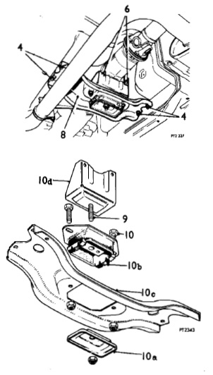

I forgot to mention you'll also need the o/d gearbox cross member and mount. There should be loads of those about as they are common for all Dolomites with o/d. the holes for it are already in the chassis rails.
