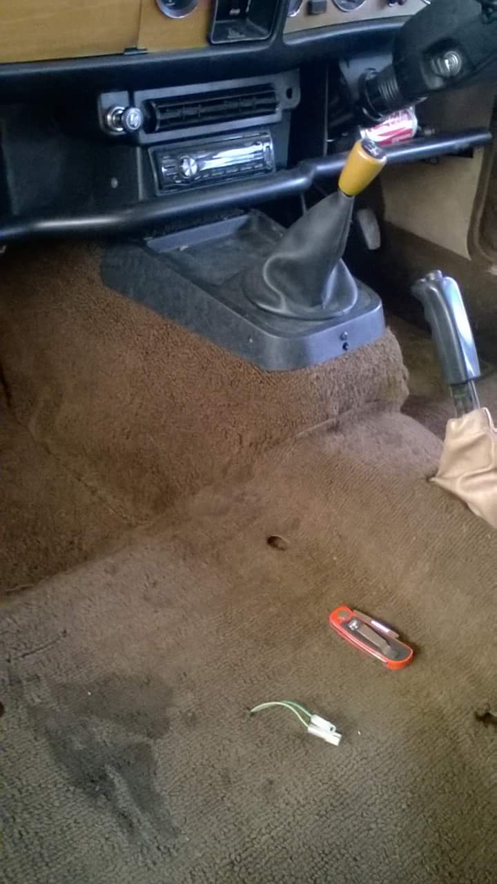

Got to spend the day at the workshop today. Got a lot !more done so not time is getting closer! The first thing I did today was fit the new radiator and fans to the car and with 2 fans cooling system works really well. Then I decided to sort the handbrake lever out. First I removed lever from car, I made a plate up to bolt it to and welded sides on to it to lift the handbrake up at an angle. I then cut the old captive nuts from the tunnel and welded new mounting plate in place and refitted lever. I got all the carpets back in and the section over gearbox tunnel fitted with a little stretching and a few cuts. Also fitted speakers under the dash as I didn't want to cut holes in the door cards. Last thing I did today was fabricate a new removable cross member for the back of the subframe.

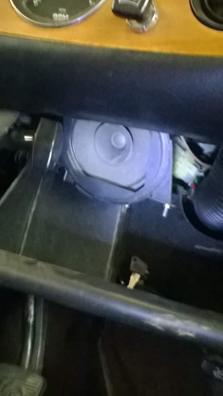

Speaker by glovebox
Speaker by glovebox
Speaker by steering column

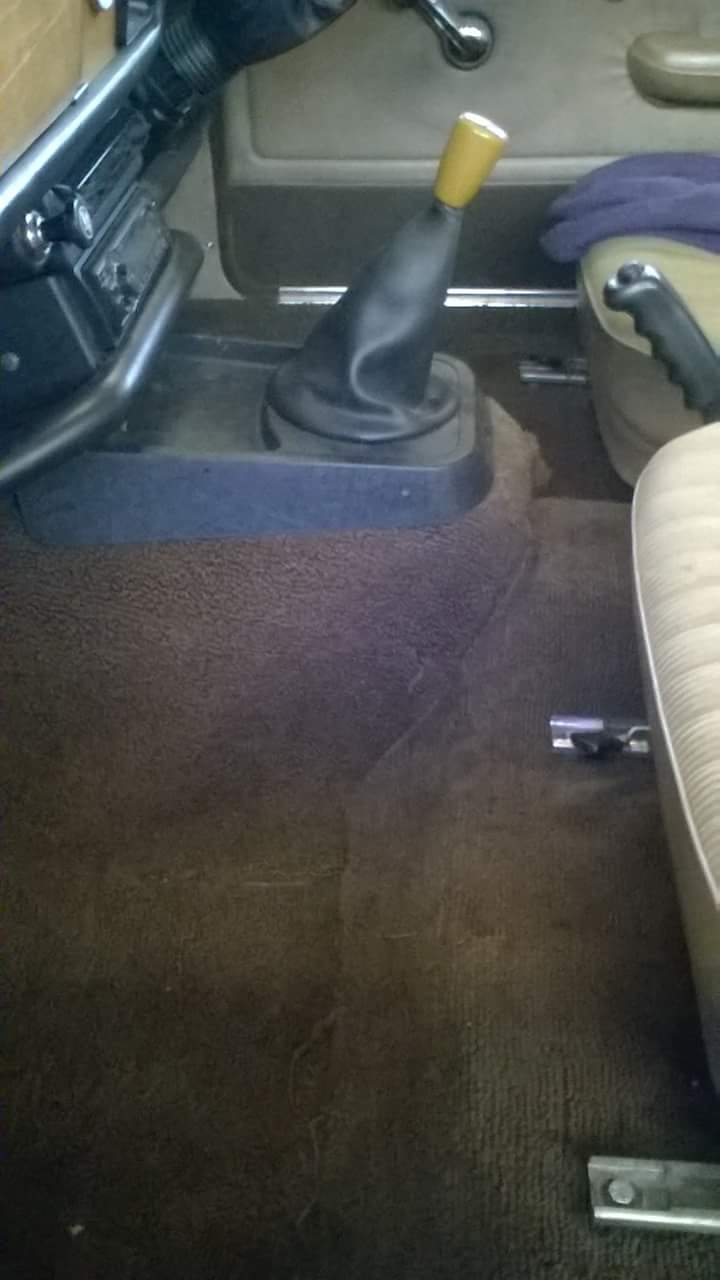

Interior back together at last
Rear seat fitted
Rear seat fitted
Seats fitted
Seats fitted
Carpets fitted
Carpets fitted
