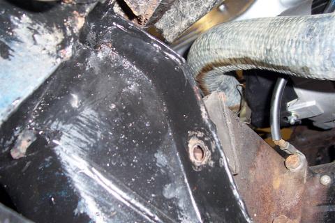

However I have found some thing else, the offside front engine mount has only one bolt holding it to the subframe. The other hole does not line up at all. I wonder if something is out of kilter.
At the moment I have it in mind to support the engine and loosen all of the bolts (including the gearbox mount) and see if I can get then them to line up. However, I'm not sure how well these usually do fit.

The front mounts should all line up hole wise...but bolts can sometimes be difficult to get in.
Take a bit of the engine weight and try and wiggle the holes in subframe and mount into line with a long
screwdriver.
Also sometimes they get fitted incorrectly. The mounting bracket has a half moon cutout that should always go towards
the top.

I was afraid of that.The front mounts should all line up hole wise
As you can see they are way out. You can just see where the flange is on the other side.
Where abouts is the half moon cut out?

Oh its an 1850....just loosen the nut on top, loosen the other sides nut and bolt a bit and it will wiggle round quite easilly if you take the load
under the sump a bit.
