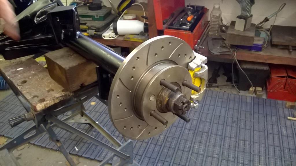

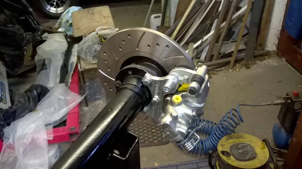

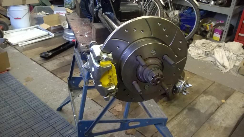

Hi,
Coincidently, I spent this weekend putting a Sprint Speed system onto my axle. Rob recommends a Fiesta disc, but I used MGF. The MGF rear disc bolts straight onto the Sprint hub, I preferred MGF because the PCD is correct, you just need to remove the hub backplate and machine a coupe of mm of it so it will fit the disc. Even the small screws for attaching the disc to the hub will fit.
It all went together really well and it fits under my 13 inch minilites although I have heard of other people having clearance problems with minilites.
Rob also provides the handbrake cables. I am some way off using it on the road, but it looks good in the garage.
Rear disc 1s.jpg (93.67 KiB) Viewed 1168 times
rear disc 2s.jpg (97.72 KiB) Viewed 1168 times
rear disc 3s.jpg (98.25 KiB) Viewed 1168 times

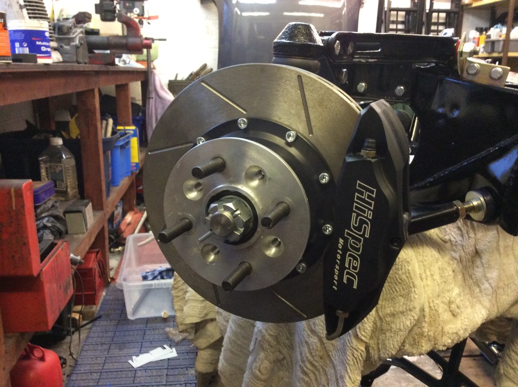

and here is my front brake
front disc 1s.jpg (222.82 KiB) Viewed 1168 times

TBH I'm with Cliff on this, I don't really see the benefit of a rear disc conversion. Unlike the just good enough front brakes, the rear is over braked and then some and It's not like you're reducing the unsprung weight with a live axle...

Galileo wrote:TBH I'm with Cliff on this, I don't really see the benefit of a rear disc conversion. Unlike the just good enough front brakes, the rear is over braked and then some and It's not like you're reducing the unsprung weight with a live axle...
Depends on what you want the car for. I agree for a road car, but track day or competition car its a different matter.
