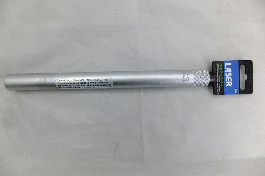

So having bought a Long Magnetic Plug Socket for Sprint getting the plugs out and in is now much easier. However getting the leads back on is still tricky anybody got some tips making that easier too.

I bought one of the thin wall long magnetic plug spanners but it binds in the plug tube just before it reaches the plug, so I can't use it !

dursley92 wrote:I bought one of the thin wall long magnetic plug spanners but it binds in the plug tube just before it reaches the plug, so I can't use it !
That is odd it works for me both on the original steel tubes and the replacement alloy ones.
