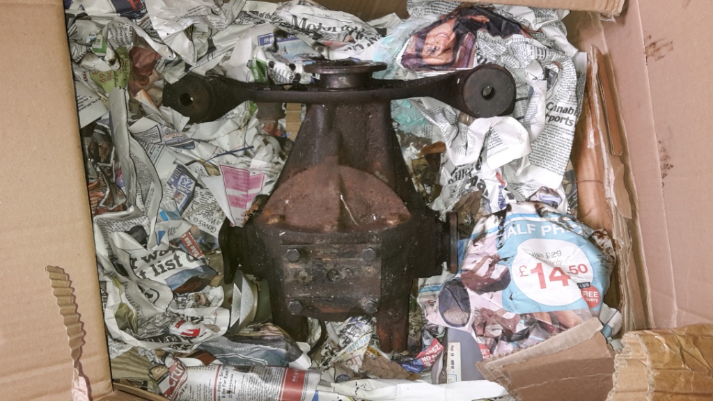

This little package turned up today. 3.63 diff.
- IMG_20160707_193924.jpg (245.68 KiB) Viewed 495 times
Re: Rear axles
So the 3.63 diff is fitted and it's made such an improvement. Not changing gear as quick and the car cruises a lot better. Keeps up with traffic a lot better now and it's much quieter than the old diff and also tighter. The old diff had a bit to much back lash which you could feel when lifting off the throttle. The new diff is nice and smooth.
