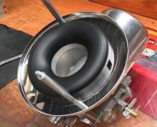

Re: Stub stacks and SU carb sizes
#19 Post by soe8m »
Almost perfect. The Dutch versions are threaded and fitted with bolts from behind. So no flow disturbing holes in the trumpet. And the vacuum bores are angled and escape at the side also not in the trumpet for the same reason.
