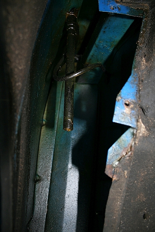

Inside the right wing, the metal is all solid and no repairs are necessary at all. In the photo you can see the radio aerial base. Incidentally I can't get the mast to extend properly, A couple of sections will come up, but the rest seem jammed. Is this type of mast still available?

I'll have a hunt on ebay for an aerial.

You can get a generic ariel for peanuts and so long as you save and re-use the original plastic and metal adapters around the wing fitting, it will probably work. But the wing hole ex-works is too large and an odd shape and most generic spacers won't have it.

As for the aerial, the problem is the extreme angle of the mounting. It's nearer to vertical than horizontal.

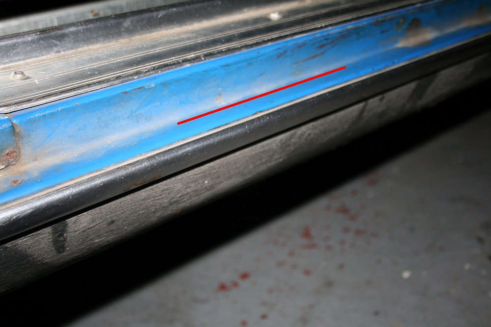

Regarding fitting the new club sill, where and how do folk normally make the top edge weld? The new sill only goes as far as the red line in my photo, so do you recommend leaving the horizontal surface intact and laying the new sill over it to plug weld, or what?

Yes cut the old sill off just inboard of the edge where the sill trim clips on. To maintain the door gap, I tap the resultant flange down a little before welding the sill on. Alternatively, if you have the tool, you can put a "set" or "joddle" in the flange which will let you keep the door gap. Technically, because this join is not an original seam, one is supposed to seam weld the sill on (or 1" of weld in every 4" by the book) But in truth it is much simpler to plug weld the sill on then clean up and a smear of filler to hide the evidence. What the tester can't see can't hurt you!
More of a problem is that the original sill structure has the lower face of the diaphragm panel attached to the inside of the outer sill so, even if your diaphragm panel is perfectly intact, (not a common occurrence) once the outer sill is removed the diaphragm will still be hanging in space. Whilst it is theoretically possible to drill the new sill and plug weld uphill onto the bottom face of the diaphragm, it's much easier to secure the bottom of the diaphragm to to the inner sill soffit by means of an extra strip of steel. Needless to say it is not a good idea to just leave the diaphragm panel hanging from a structural point of view!
Get a generic "high angle" ariel and use the original spacers and you should be OK.
