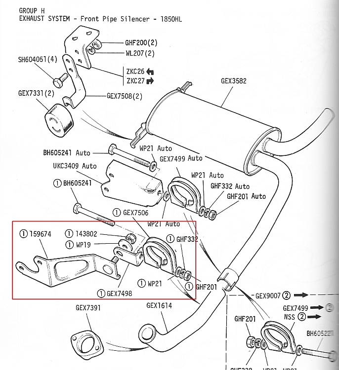

On another matter, looking at the parts book last night I notice that the bracket highlighted in my scan below is completely absent on my car. I assume it is desirable to have it, so has anyone got one? I suppose at a push I could manufacture something similar, but better to use the correct part if I can.

Essential reading:
viewtopic.php?f=4&t=32065&p=298143&hili ... et#p298143
and the bracket (or A bracket) is a must.

Thanks for pointing that out. I have sent a PM to Alun.
