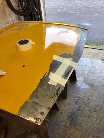

Had a few rainy days, surprise !!! So built the 45's up on the manifold and pieced together the linkage which you need three hands for, minimum! Also made a start on the bonnet which like the rest of the car had holes hidden with filler so cut it out and patch panels made and welded in. (Thanks Mart for the tip on covering the paint stripper with bin bags, works well). I think by the amount of dents in it and the roof someone stored stuff on it for years.

- Bonnet stripped ready for hours of prep due to loads of small dents.
- image.jpeg (89.71 KiB) Viewed 5200 times

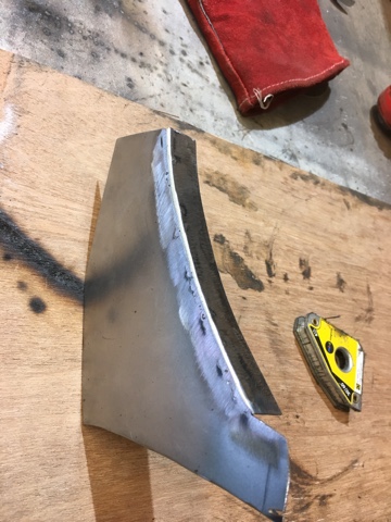

- Patch panel ready for welding
- image.jpeg (82.61 KiB) Viewed 5200 times

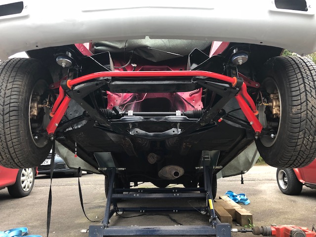

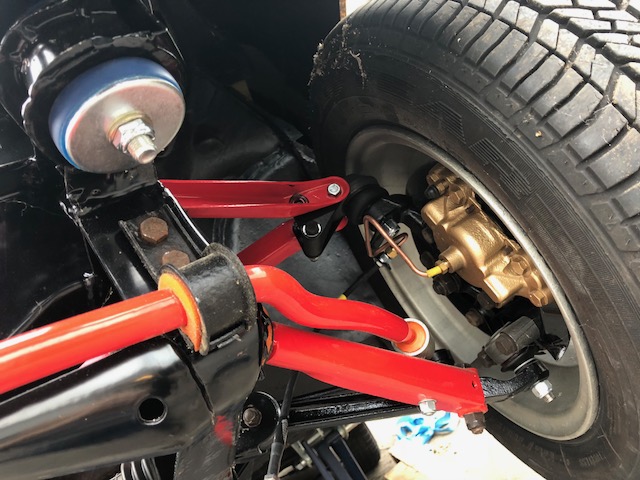

Made the most of the good weather and got the car finally back on its wheels. Sub frame, suspension and shocks all in.
- image.jpeg (151.58 KiB) Viewed 4954 times
- image.jpeg (148.45 KiB) Viewed 4954 times
- Subframe
- image.jpeg (117.3 KiB) Viewed 4954 times
