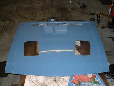

Will this be enough for a Dolly?
Posts: 7242
#917 Post by Carledo »
dollyman wrote: Mon Jul 09, 2018 3:10 pm Will this be enough for a Dolly?
Serious overkill IMO!
Find a pic of a stock MkI/II GT6 bonnet, the top louvres are just about perfect, in both size and relative position! Ignore the side ones on the MkII, pretty as they are, the Dollies solid flitches would make them purely ornamental and you look a bit silly!

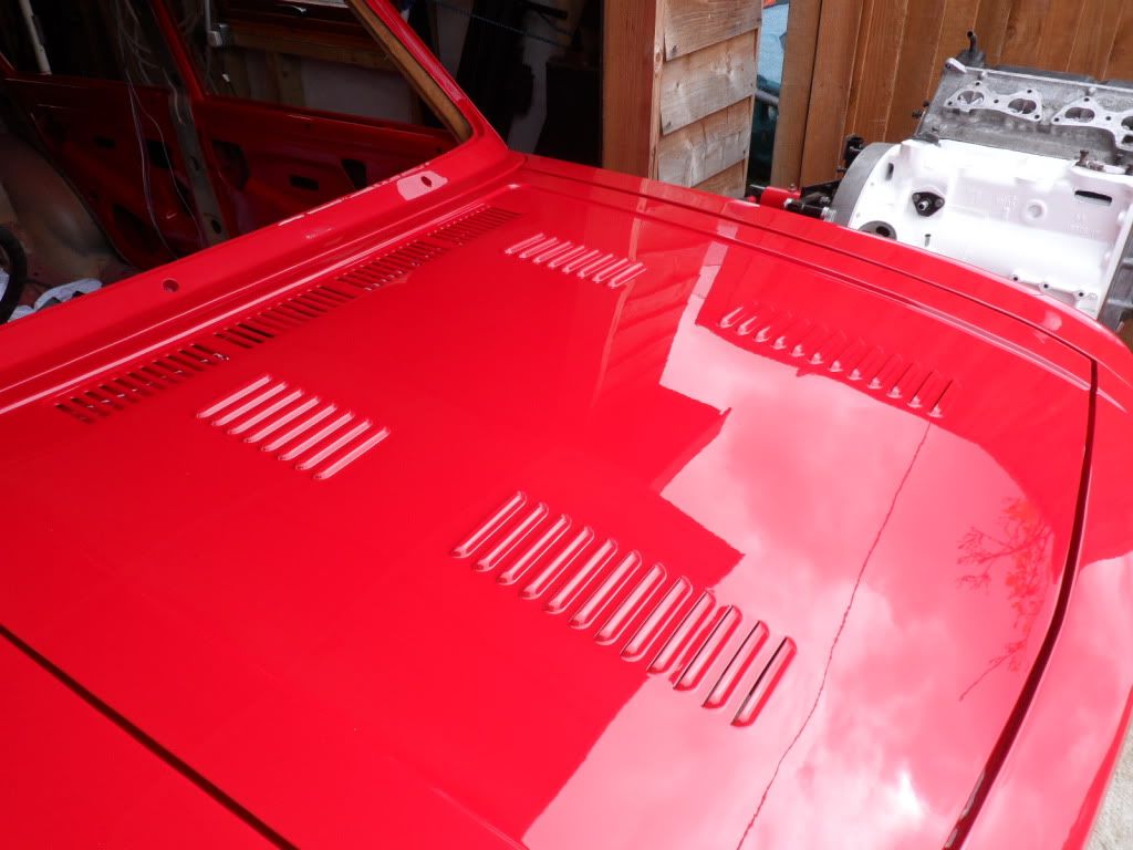

#918 Post by Mad Mart »
This is where I positioned the ones on my ex track Sprint. I wanted to go further back but that's as far as I could go without cutting the bracing.

Mad Mart wrote: Mon Jul 09, 2018 8:35 pm This is where I positioned the ones on my ex track Sprint. I wanted to go further back but that's as far as I could go without cutting the bracing.
Now those look really good :D God know's what was under the bonnet of my pic to need that amount of louvre's :lol:
#927 Post by tony g »
They are probably in the best position for air flow imo. What are the vents from Mart?
Posts: 8529
#928 Post by Mad Mart »
I actually found the link to the vents:-
http://www.body-kit.co.uk/product.php/1 ... 1109df1216
They were only about £16 each when I bought mine. I think I got mine off Ebay though iirc.

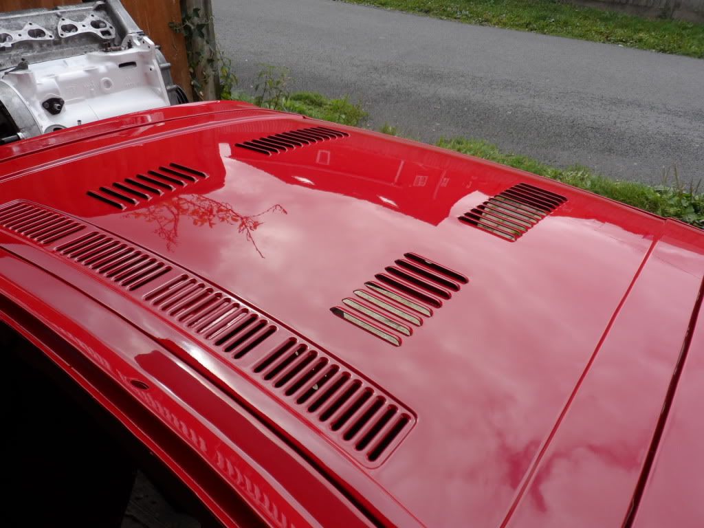

Tony Burd
Posts: 1248
Location: Andover Hants
#929 Post by Tony Burd »
My car is staying cool in this weather, needle not going above half.
Link to the lourves I had pressed into my bonnet:
viewtopic.php?f=3&t=24824
I am using the Saab rad & Volvo header tank plus Evans Waterless coolant.
