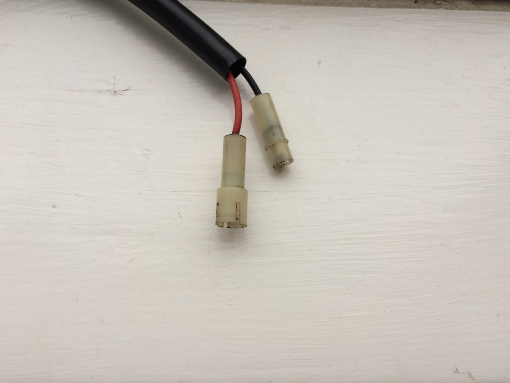

What sort of electrical connector is this?
DavePoth
Posts: 5723
Location: Next to my Computer
#1 Post by DavePoth »
I can't figure out what sort of connector this is. The new version of the number plate lamp has bullet connectors on the end of it which won't fit the loom - I could change them easily enough if I knew what they were so I could buy some! Any thoughts?
dollyman
TDC Cheshire Area Organiser
Posts: 1410
Location: NANTWICH.
Re: What sort of electrical connector is this?
#2 Post by dollyman »
I seem to remember those as a glass fuse holder Dave? Usually on radio's and cassette players. Cant say for certain though. https://www.ebay.co.uk/itm/Fuse-Holder- ... Swtn9ZziHK
This is the nearest i can find.
GrahamFountain
Posts: 1735
#3 Post by GrahamFountain »
These are Lucas RISTS 3mm connectors. I can't find anyone selling these 1-way connectors, but you can find the inserts on ebay (https://www.ebay.co.uk/itm/132103510265) and Steve at S&S is bound to be able to sell you a couple of good shells - they are all over the TR7s.
Graham
Flyfisherman
Posts: 980
#4 Post by Flyfisherman »
DavePoth
Posts: 5723
#5 Post by DavePoth »
Flyfisherman wrote: Sat Nov 23, 2019 8:48 pm Dave
are these of any use:
https://www.autosparks.co.uk/electrical ... inals.html
paul
Perfect, cheers Paul!
