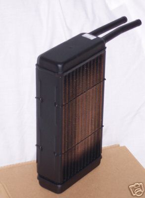

Scimitar have different heater matrix’s depending on year.
Below is the 75-85
http://www.vehicleheaters.co.uk/Heater% ... liant.html
Sold my Scimitar SE6a to get the Sprint back.
Below is the 75-85
- 1975 to 1985
- 58123AAD-7BE0-4926-80BC-5418B3801E65.jpeg (20.23 KiB) Viewed 2664 times

Thanks for this,SprintV8 wrote: ↑Sun May 10, 2020 9:50 am Scimitar have different heater matrix’s depending on year.
Below is the 75-85
so the Scimitar SE5a had a matrix 10mm taller and 8mm deeper
this being a volume increase of almost 25%.
Oh and a T2000 matrix is 35% bigger but completely the wrong shape.
