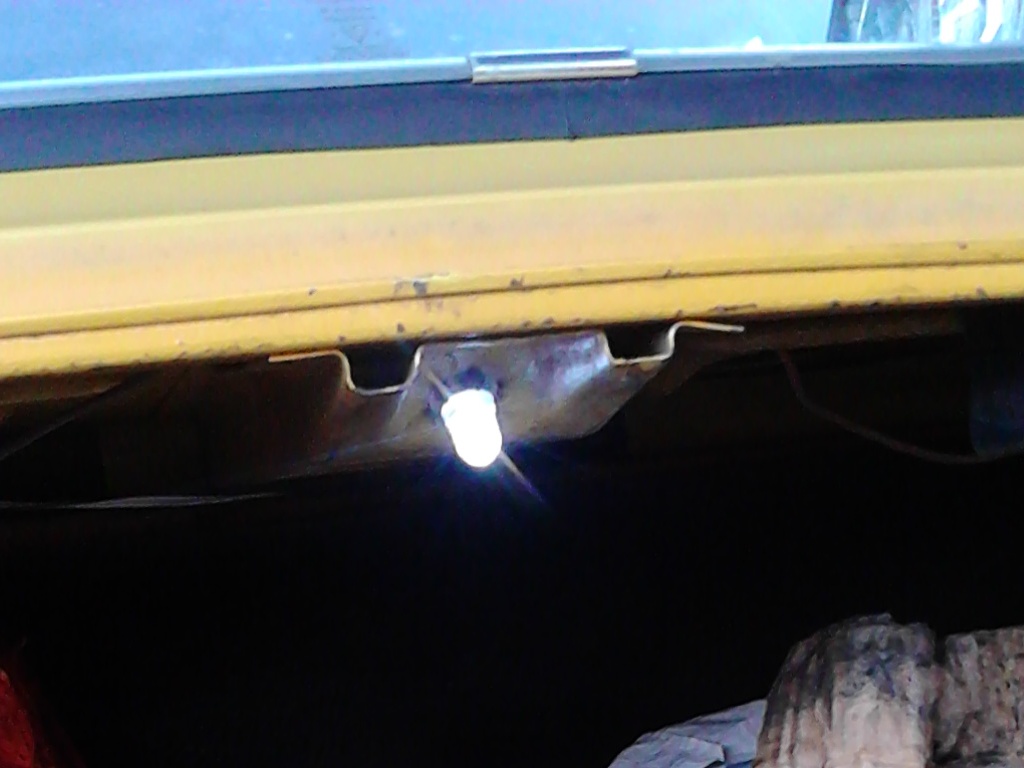

Here it is working. Now how do I make sure it goes out when I close the lid?
Graham
Graham

Looking at the size of ediscrew M10, 9.3mm diameter, it looks like that's the one, and getting the GLB233 to fit felt like a total bodge because it was.
I hope it comes out now!
Graham

Are these single LED 233's too directional to go in the front sidelights?
Wanted an LED for the boot cos I leave it open all day sometimes. But I'm not sure I want LED sides.
Graham
Graham

TBH i'm not a fan of LEDs on required legal lights - because they aint legal! I KNOW the pros and cons, but till they ARE legal (IF and when) i'll stick to tungsten and tungsten/Halogen for heads.
I have no such objection to using LEDs for boot, underbonnet, interior, instrument panel illumination etc.
I have an LED high level brake light (not a legal requirement) and I got 6 of these LED strips for £8 off ebay to light up the boot and underbonnet.
2 ways to test the switch!
1) climb in the boot and close it (remember to take a torch with you to find the release)
2) treat it as an earth leakage test, put an ammeter across between the removed battery earth terminal and battery -ve, read with boot open and again closed, if the second reading is lower, it's working!
