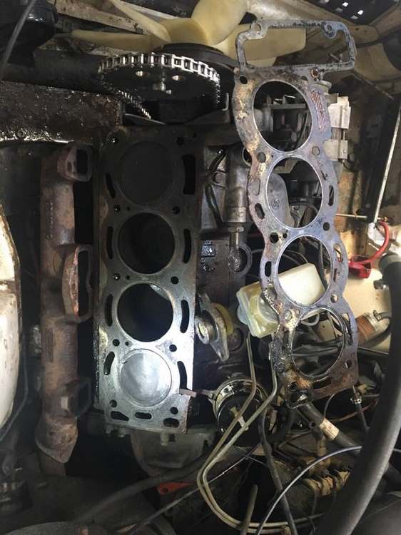

today was a Lucky day . the head was not too tricky to put off .
good girl !

Hello ,
Need one information :what is the maximum value we can skim the head ?

dololo wrote: Tue Nov 26, 2019 2:10 pm Hello ,
BL stated minimum head thickness was 4.427" (112.45mm) for the 1850/TR7, same as the Triumph Stag.
Measured as shown in pic.
Roger

So the head was impossible to skim again
i put an other one,improved the water holes to match the gasket and an improved radiator .
wait and see ...
