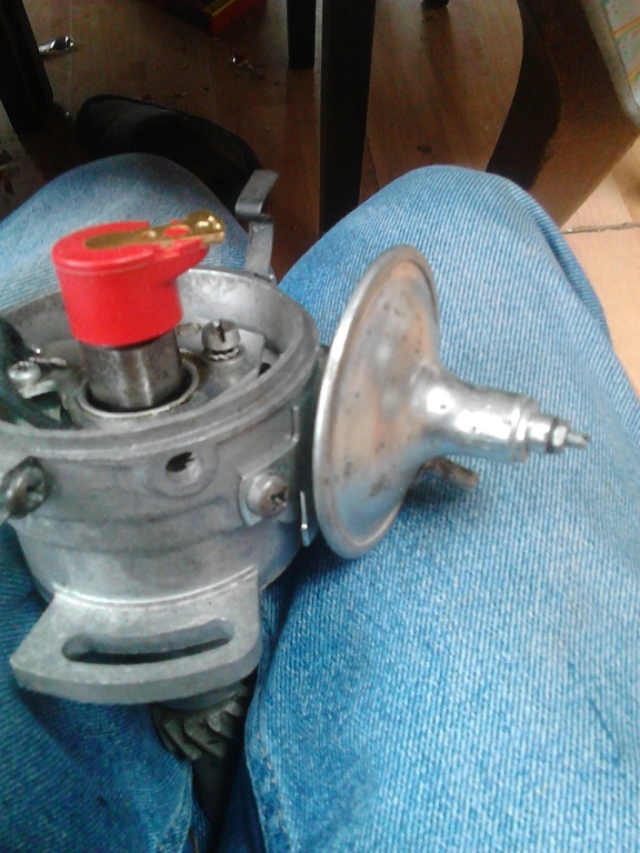

#1 Post by GrahamFountain »
I came across this adjustable vacuum unit that fits the 44D4. At least it fits this 41402 one that has a NOS early 45D baseplate in it, which has the slightly longer pin under the points plate to connect to the vacuum unit's arm - but not as long as the remanufactured 45D baseplates, so it misses the bob-weight post tops.
It seems like the screw controls a simple stop on the maximum limit of the advance, and the rate of advance with vacuum, as in deg/mmHg, is what it is.
What I can make out of the numbers on it are T 3 3 54425079. Where 54425079 is a Lucas vacuum unit number for a 45D, but that does not seem to be adjustable. I've not seen anything like it before.
So I was wondering if anybody knew anything about these adjustable ones, and or have thoughts on setting it up?
