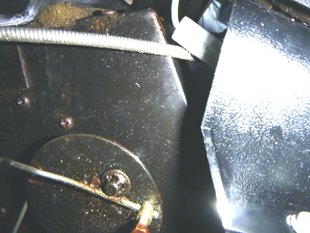

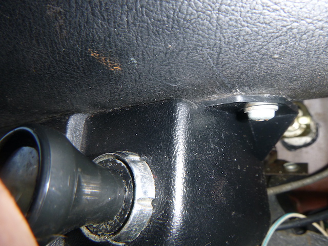

Hi Clive, This problem of the heater valve sticking may be an 1850 "thing" as I had to do mine back in the Spring as well. Yes, it had stuck on "hot" . I took some photos as I did it. As Mart says the heater valve is on the right hand side under the dash. It is on the same level as the choke knob but further forward. If you set the driver's seat as far back as possible you will be able to see both the circular opeating cam and the valve. I just tweaked mine from under the dash and operation was restored.
HTH,

- rotary cam.JPG (195.74 KiB) Viewed 837 times
- heater valve.JPG (190.82 KiB) Viewed 837 times
- choke and heater valve.JPG (174.2 KiB) Viewed 837 times
