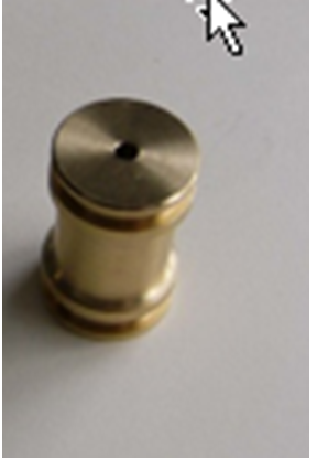

We have converted our Dolomite Sprint using a electrical waterpump, we have removed the original waterpump and inserted the waterpump bung. All this is working ok, however the heating inside of the car is not working verry well. We have been looking for the root cause of this and found in some articles that we should replace the bypass tube with a bypass tube as shown on attached picture.
Can anyone let me know where I could get such a bypasstube.
As I am not so sure that the picture will be visible, the bypass tube I am loong for has just a verry small hole at the top of the tube
This would be very helpfull to complete the work on ourt Dolly
Thanks for any advice
Nico

Don't know where to buy them from, but try taking your original by pass tube to a machinist, so he knows the dimensions of the original and they can modify it to your needs, that's what i did

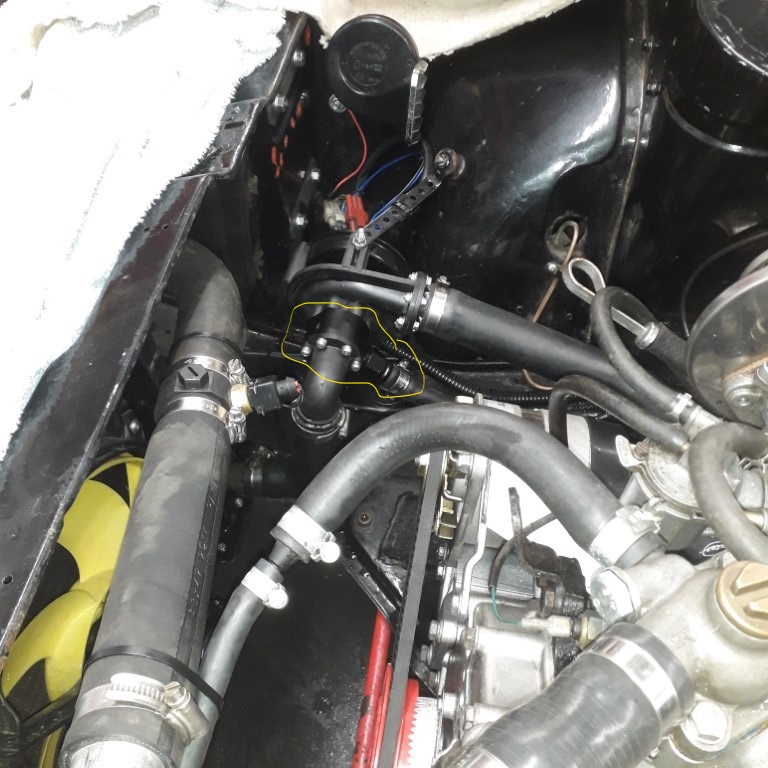

I am at a similar stage in fitting an EWP as you (see https://forum.triumphdolomite.co.uk/vie ... =4&t=37619).
I don't think that the alternate bypass would help your heater flow, although the Sprint heater connections are different to my TR7 Sprint.
You have to remember that the standard heater flow is designed to come back into the water pump at the suction side. As you have now moved the pump, the heater has no flow direction.
I re-routed the heater outlet to the inlet side of the EWP using a connector from T7 design.
https://www.t7design.co.uk/t7design-hea ... c-6e6.html
See attached photo - you can see the heater pipe circled.
How did you blank off the bypass tube? That is where I am getting an annoying leak.
Jerry
heater connection.jpg (190.46 KiB) Viewed 5390 times

JerryTR5 wrote: Sun Jan 08, 2023 8:05 pm How did you blank off the bypass tube? That is where I am getting an annoying leak.
Jerry
Core plugs, one in the inlet manifold and the other in the pump cover

When you fit an EWP the in-car heating does become intermittent or even non existent. The answer is to tap into the back plate on the cylinder head and take a hose from there and tee in to the existing heater hose flow.
dursley92
Posts: 524
Re: Conversion to electrical water pump
#6 Post by dursley92 »
Mad Mart wrote: Mon Jan 09, 2023 9:56 am When you fit an EWP the in-car heating does become intermittent or even non existent. The answer is to tap into the back plate on the cylinder head and take a hose from there and tee in to the existing heater hose flow.
That rear take off is what is used on the TR7s. The few real TR7 Sprints they made had a special rear takeoff casting but they are incredibly rare.
I have Sprint engines in my TR7s with a simple adapter plate sold by Rimmers, fairly crude but does the job. Basically just a plumbing elbow fitted into a Sprint plate.

The Davis Craig EWP is designed to function WITHOUT the benefit of the normal engine thermostat. On the Sprint engine this thermostat performs a double function, the "foot" on it closes off the bypass pipe when the stat opens, the bypass pipe only functions during warmup.
The brass "pinhole" bypass pipe is DC's solution to the problem of cooling path confusion from not having the stat. It allows a miniscule amount of water to pass the "wrong" way when running but crucially it lets air rise up to prevent airlocks when filling etc that might otherwise prove hard to dislodge.
HOWEVER, Ian above and others have proven by experience that blanking off the bypass with a couple of core plugs is not fatally detrimental, does not inevitably lead to hours of frustrating airlocks and has the distinct advantage of rarely being a source of leakage, which is more than can be said for the bypass tube, standard OR modified.
NEITHER will make you heater work better!
To give the heater ANY chance at all, you MUST re-route the heater return to BELOW the pump (ie between bottom hoseneck on rad and water pump) and blank the original return on the engine water pump housing.
Further benefit is gained by using the TR7 Sprint style hoseneck for the supply to the heater and blanking the original under manifold fitting as the backplate area draws the hottest available water.
Most people who have got this far will now introduce a "proper" clear header bottle and pressure cap into the system, Tee-ing it's feed into the bottom hose and tee'ing the heater return into the feed from the header.
Sorry if this sounds confusing, i've done a flow diagram to explain it but can't find it since my photobucket account died.
Finally, if you still don't have the heater you want, DC offer a small in (heater) hose electric pump purely to speed up the flow and make the heater work better. It's not elegant and fixes the symptoms rather than the cause - but it does work!
Or you can do what I did and put a Vauxhall engine in, all my Vaux powered Dolomites have excellent heaters! But its a bit of a sledgehammer solution!

Yes, used a solid bypass tube, no small hole, and it worked fine. Never thought of the idea of using core plugs, but as long as they don't leak, it sounds like a reasonable idea.
