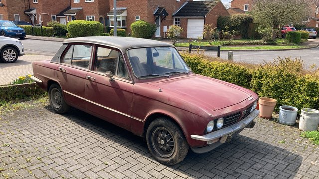

15th December 2007 I was driving home from Nottingham when the car started making a horrendous noise. Long story short I was recovered home with the recorded fault being 'BIG ENDS':
Since then:

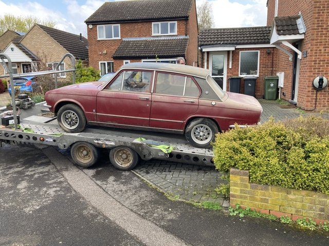

The car has very kindly been stored by others. Most recently in a barn for at least 12 years, maybe longer. It was transported home (by a great guy) last Saturday (15th April 2023) where I was able to have a better look around it, and my daughter and nieces had a great play in it (which was worth bringing it home for alone):

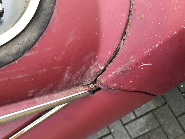

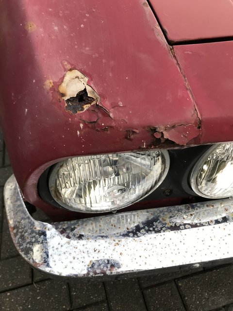

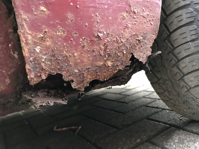

This looks pretty terrible:
This isn't looking great either:

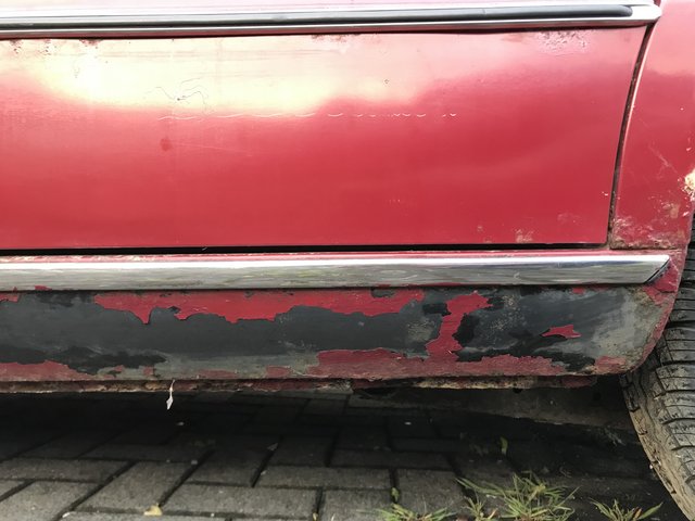

3. There was quite a bit of paint missing from the sills or that came off during the inaugural wash. I'd assume the paint provides some level of protection against the elements. Is it worth repainting these by hand for the short term? As per the above photos, I have a tin...

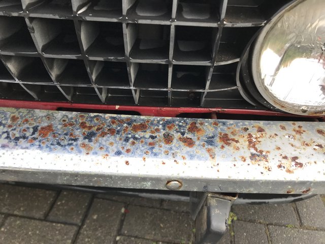

4. Really basic question: any tips for how to clean up the bumpers? I'm hoping they are restorable, rather than needing to be replaced (photo above).

The very first thing you must do, is a thorough and critical assessment of the condition of the body and underbody. Get a Dolomite expert to help you with this. With your admitted ignorance of any mechanical or body restoration techniques, you are probably going to need to employ a welder to take care of bodywork issues (you seem to have a few) which will probably end up being more extensive and expensive than you've budgeted for. So make sure before you start that you know what you are up against!
On a more cheerful note, the engine issues that caused the original layup are not a big deal. I'd be surprised if the "big end" diagnosis is correct, it's not something that usually troubles this engine, but even if it is correct, it's fixable, though a good used engine may be the cheapest solution.
Don't worry about the sill paint, the black that is showing through is the proper original colour and the red that is peeling is a poorly applied mistake by a later owner.
On the bumper issue, try a bit of chrome cleaner and elbow grease, but I wouldn't hold your breath! They look a bit far gone to me, but if your goal is "usable" rather than "excellent" you may get away with it. If you can't live with the results, new bumper sections turn up from time to time, as well as better-than-yours used examples. I might have a better front one and a NOS rear centre section in my own collection of bits.
But bumpers are a bit academic at this stage, you need to get the body right first!

Bumpers: I thought this sounded completely daft but having tried it myself it does actually work, I don't think its a long term answer and certainly not an alternative to replating but if you scrunch up (into a ball) normal kitchen foil, dip it in warm water and then rub it over the bumpers it does actually improve them a great deal, as I say, I was cynical when I first heard of it but it does make a significant difference in their appearance, try it, it costs nothing!

Noted on the bumper point(!), I just thought it was something I could do now to feel like some progress was being made... an easy win to get me started!

I'll give the kitchen foil trick a go and report back - thanks for the tip!
