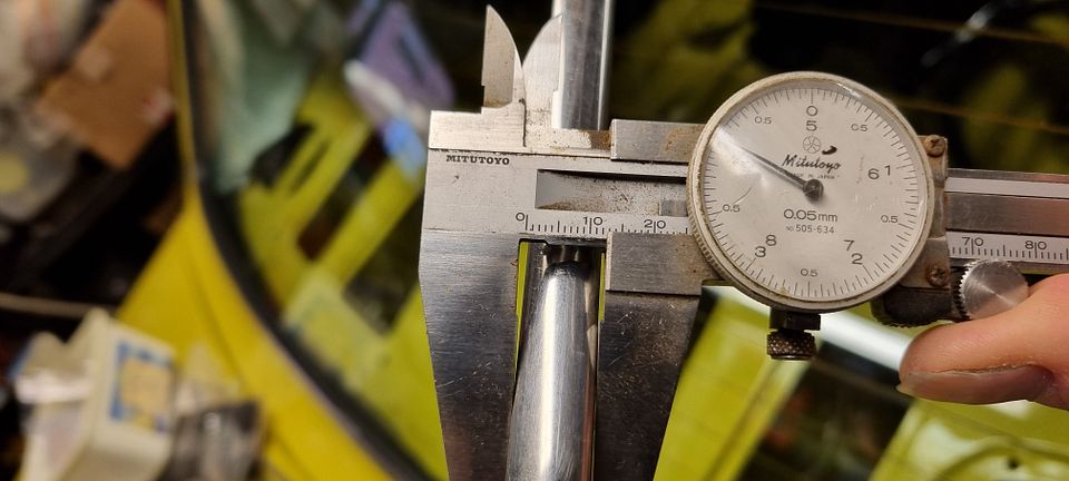

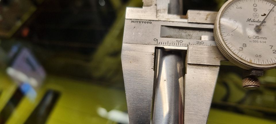

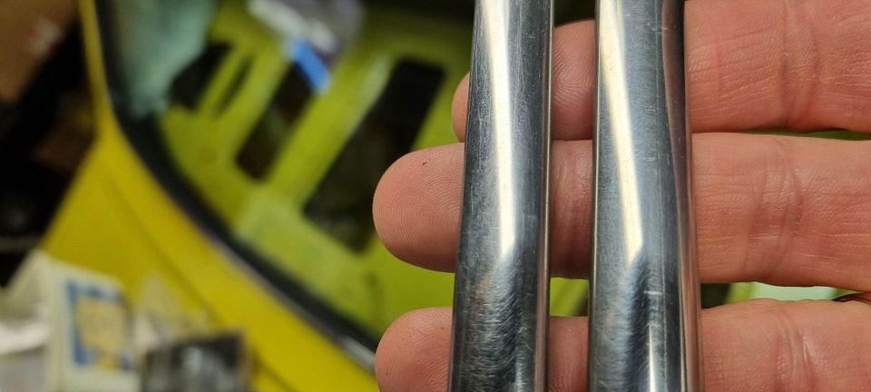

Ignore the dial on the caliper it is out, non Sprint are just under 13mm across the widest part
Sprint trims are just over 14mm
So about 1mm larger, side by side you can see the difference, Sprint on the right
If you do have a spare offside one Alun I would be interested, I would probably pick it up from you. For now I can pinch the one of the other car so no rush.

Has this size difference got more to do with the trim clips that are used on the gutter?
All the early Dolomites (1850s) that I have done haven't had these trim clips that go on the gutter (and no vinyl roofs), but the Sprints and later cars seem to have them. I wonder if it has anything to do with the vinyl roofs, larger trim with a clip to accommodate the vinyl for the roof?
JGJ has these clips.
Tony Burd
Posts: 1248
Location: Andover Hants
Re: New Project VA485 - RPJ 7L
#217 Post by Tony Burd »
Yes the larger trim is to accommodate the vinyl that overlaps the top of the gutter on Sprints. For this reason there is usually a clip or two added to the A post where there is no vinyl.
Non Sprints have the narrower trim & don't need any additional clips.
Later non Sprints may have used Sprint trims (maybe they consolidated the trims to the larger ones) in which case they would needs clips on the main gutter & A post area.
