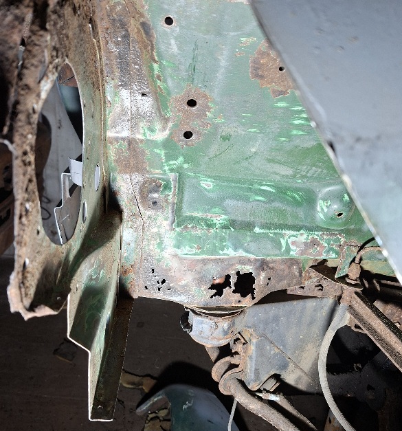

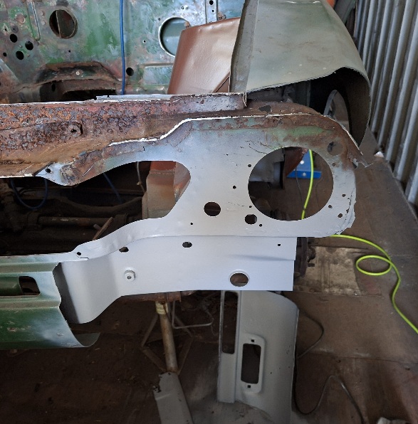

Today I thought I'd repair the left eyebrow but after a few hours of cutting I've found a solid starting point! Cleaned up, rust treatment and primed ready to be made solid again.

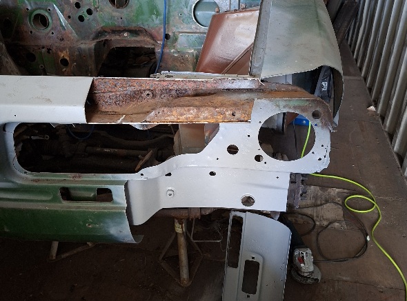

#274 Post by Philgroom »

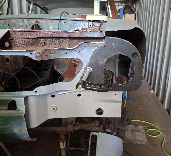

A few more pics

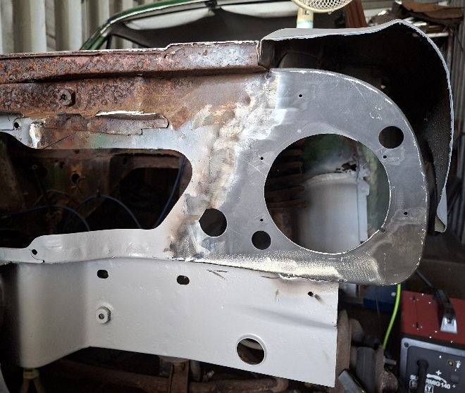

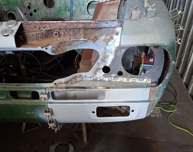

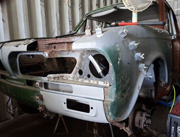

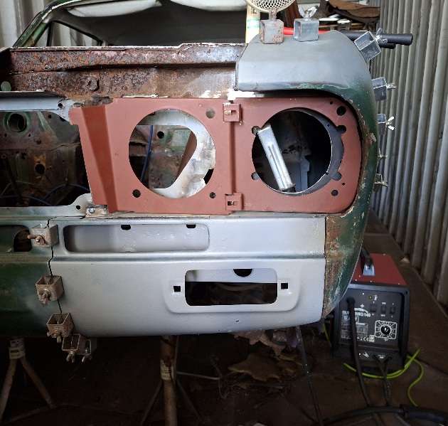

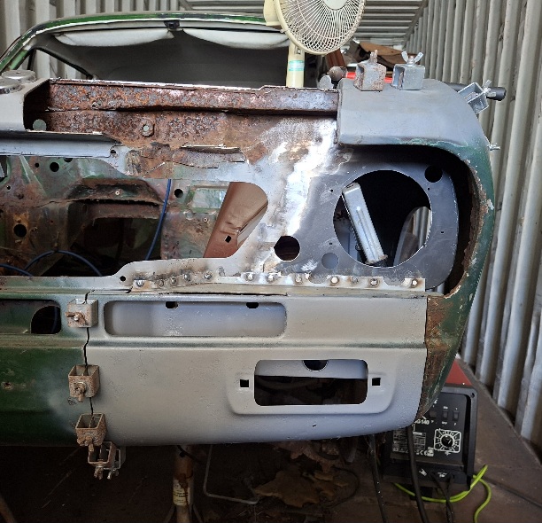

Started to build up the front corner. Had to temporarily clamp the outer panels on to make sure they all line up again. Found the repair panel for the top valance is going to need a bit of modifying as it sticks out past the front of the wing quite a bit.

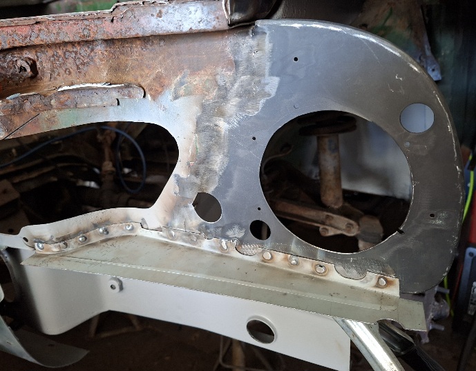

#279 Post by Philgroom »

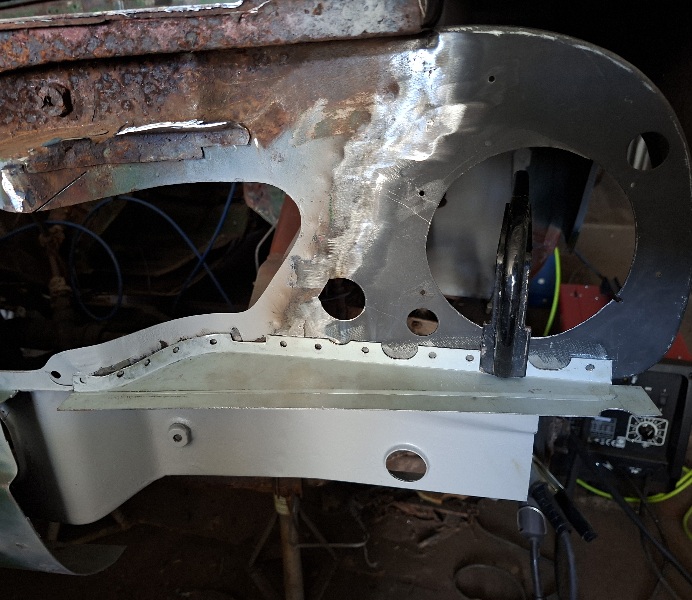

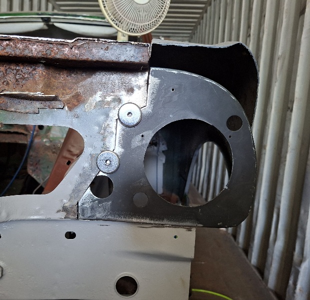

A couple more pics
