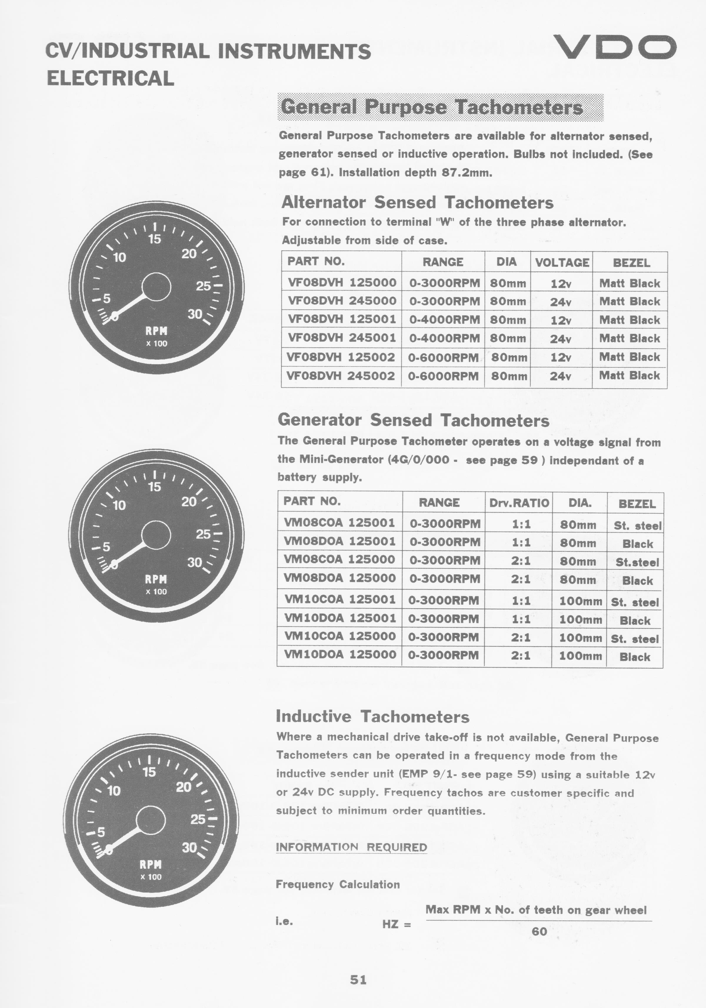

Smith’s style gauges manufactured under VDO ownership
Looking through my archived, 64-page, British 1992 edition, VDO Automotive & Industrial Products Catalogue (Autocat 925 | VDO Special Products, Holford Drive, Holford, Birmingham, B6 7UG, England), I found on Pages 50 to 63, various industrial, commercial vehicle and sports car gauges, manufactured at their factory in Caerbont in South Wales, to Smith’s original specifications as follows, which I had recently posted in The Samba Literature Archive (mainly concerned with literature pertaining to classic Volkswagen vehicles and accessories):
Introduction – Page 50
Commercial Vehicle & Industrial Instruments – Pages 51~54
Traditional Sports Car Range – Pages 55~57
Corresponding Gauge Senders – Pages 58~59
Switches – Page 60
Accessories – Page 61
Wiring Diagrams – Pages 62~63
All of the pages in this catalogue, which include the VDO Cockpit & Proficockpit range, were and still are popular for classic VW-Audi cars, can be accessed at the following Internet link:
1992 VDO Products Catalogue, Stockist List and Price List
https://www.thesamba.com/vw/archives/li ... atalog.php
In my 1973 model-year VW “1600” Type 2 Kombi based Westfalia Continental motorcaravan, I have several examples of the VDO Cockpit range of accessory gauges (see Pages 5 to
; many of which have been bought as modestly-priced, new-old-stock items.
