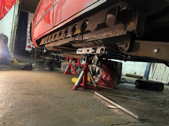

What I’ve been mainly working on is rust repair. Jesus Christ, the rust. I’m going to have PTSD from the amount of rust repair I’ve had to do. I knew there was some rust that needed repairing but every time I start the repair, I end up finding bad repair after bad repair, which leads me to cutting out more than I envisioned and taking far longer than I anticipated. So far, I’ve repaired the Drivers Side “A” Pillar and the front subframe mount, both were quite badly rotten.
What I’ve been doing for the past week is the passenger side sill. At one point, I jacked up the car using the rear jacking point and as I lowered it down, I could hear the sound of rusty metal breaking, so my dad repaired as best he could (this was around 9 years ago).
After finishing off the mechanical bits and pieces, I go through and start sorting out some of the more serious rust spots out and I have a look at that jacking point and after several years of being sat on axle stands, the rear half of the sill had started to fold in on itself. So I start cutting and find some terrible repairs that has left the sill reinforcer panel basically not attached at the bottom for the whole length of the sill
. So I’ve had to cut out the entire outer sill panel (which was also very rotten along the bottom) and almost all of the lower inner sill (both rotten and badly repaired) and about an inch off the whole length of the sill reinforcer. I’ve made good progress so far on the repair; repaired most of the lower inner sill, significantly strengthened the rear jacking point with some 2mm plate, and made a repair panel for the reinforcer. This has been at least 40 hours so far and it’ll probably take another 40 to finish.

- How badly the sill had been repaired. They just put 2mm plate across from inner to outer sill

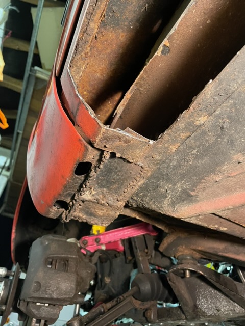

- How much I had to cut out

While sorting out the passenger side sill, I ended up looking at the drivers side sill in the hope that I didn’t need to do anything as it didn’t look too bad.
Then, I started digging… and digging… and digging. In total, basically half of the sill needed replacing as the lip above the seam had just gone and you could move the inner reinforcement panel (what was left of it) with your finger. When I cut the outer sill off, the bottom 2 inches of the reinforcement panel was gone. And not that it was weak or crumbly, I mean it wasn’t there at all. I also ended up looking at the join between the sill and the drivers side floor, which was also very rotten. And as the drivers floor had previously been patched to hell, I ended up making a new drivers side floor along with the front 3 feet of sill panels. I also discovered that the front cap for both of the sills were also entirely missing! They were fun to fabricate up.
How much material I had to remove from the drivers side
In total, I’ve added around 6-8 square feet of new metal to the car!!
