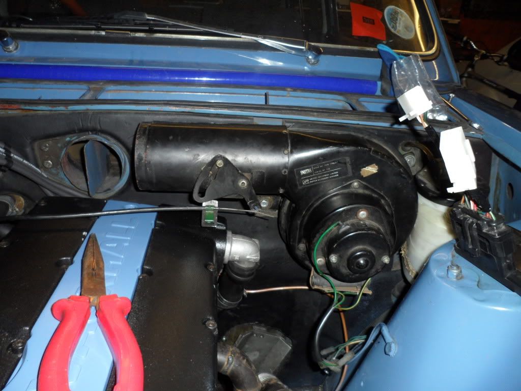

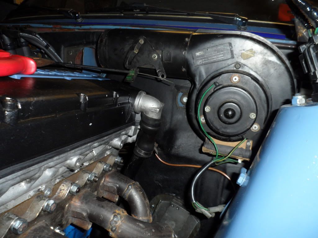

Heater fan flap repositioned again, so it does not hit the bonnet.
Exhaust manifold now fitted.

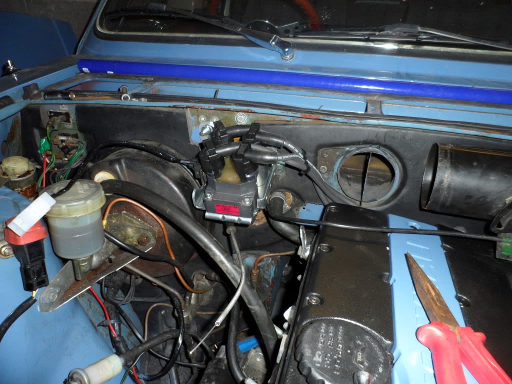

Wiring connectors made up for Edis unit, Throttle position sensor and coil pack.
Coil pack mounted to bulkhead.

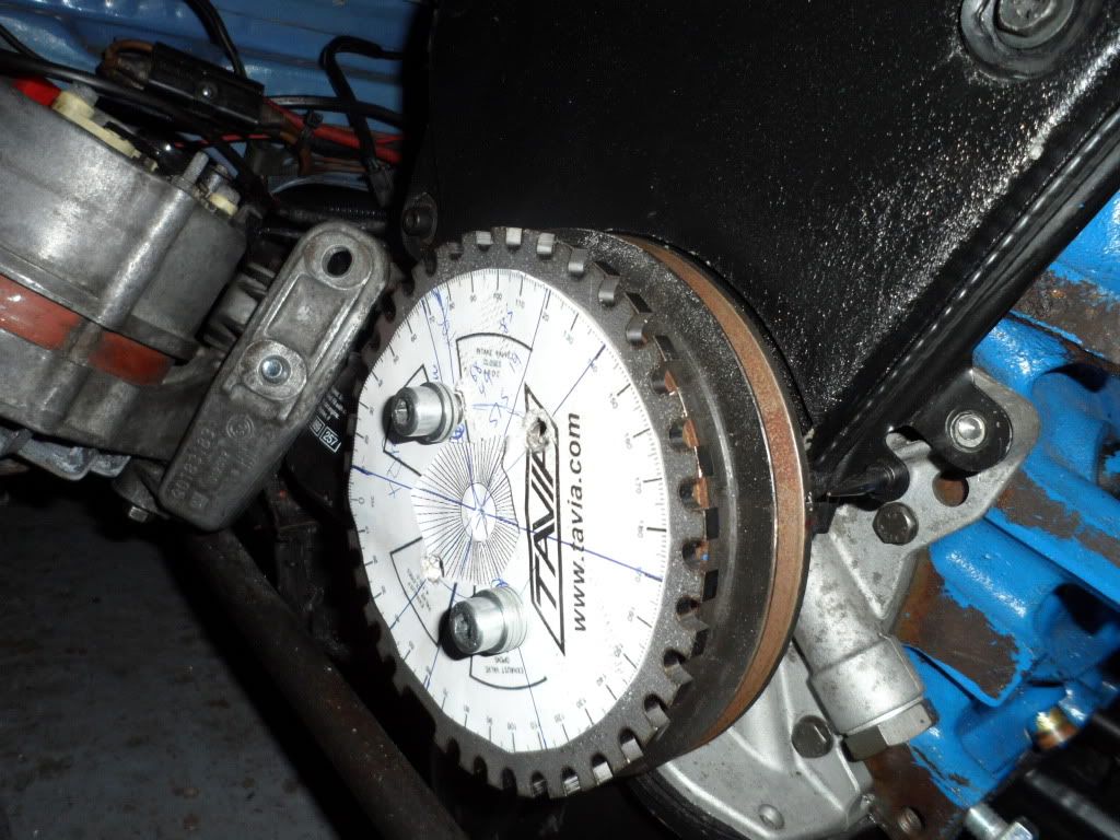

Feels like I am starting to get there now. Next job is to drill the toothed wheel so it fits in the right position relative to TDC and make up a simple bracket to hold the voltage reference sensor in place.

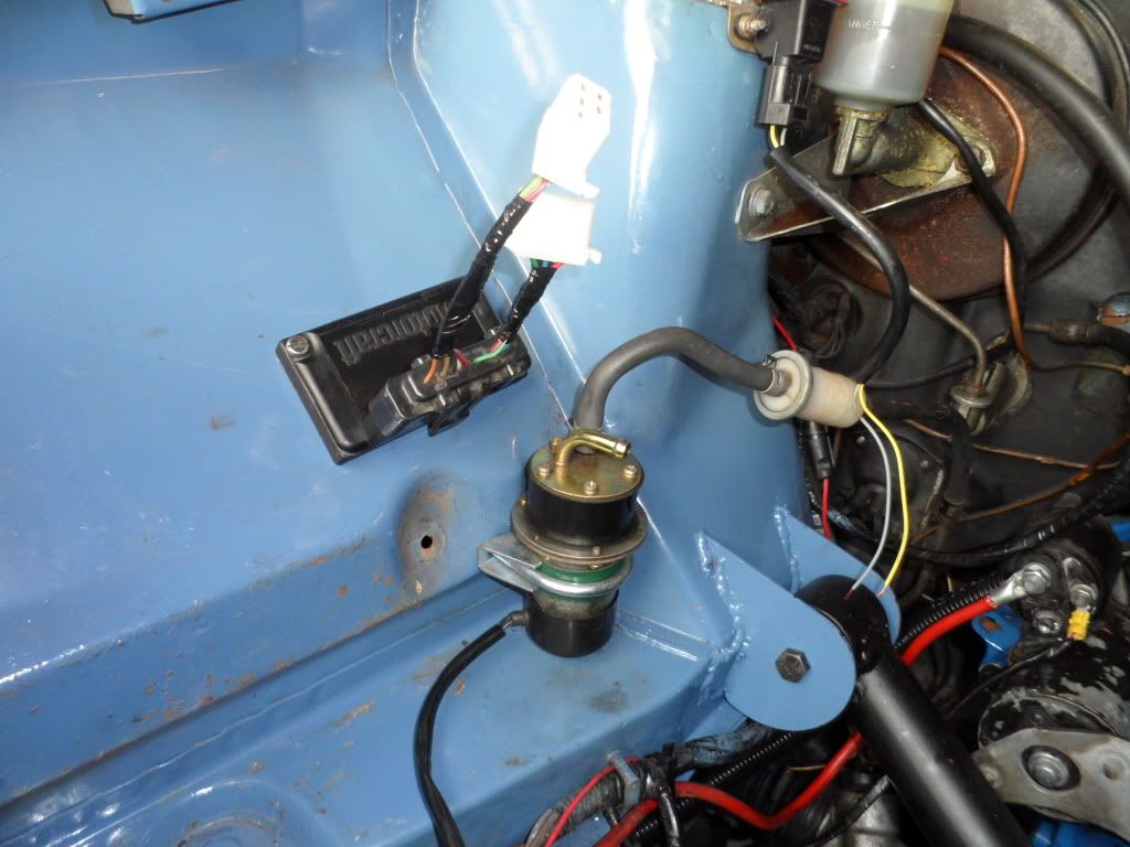

Fitted R1 fuel pump and filter
Fitted Edis unit. This will sit below the volvo 240 header tank.

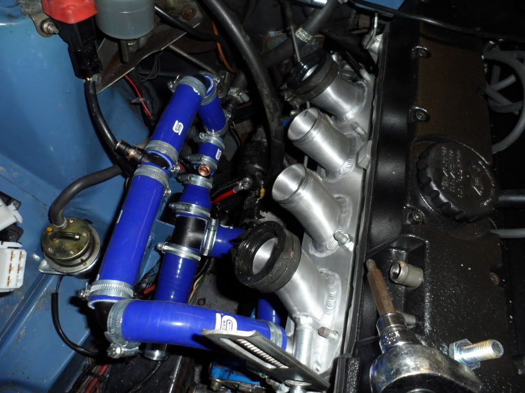

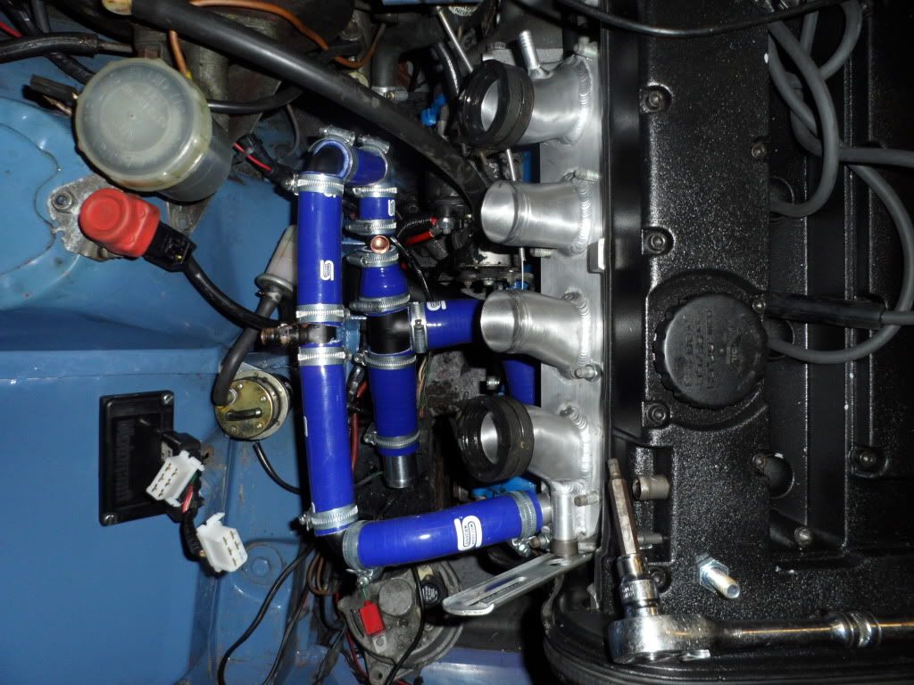

More bits and bobs.
Cooling pipework completed, bit of a mare getting it all in there but hopefully it will do the job. Heater matrix included in pipework design so I can keep my toes warm
Throttle cable fitted to R1 carbs.
Checked R1 carb main jets - they should have been 1.8 mm diameter. They were 2.35mm so would vastly overfuel at full throttle. Just bought some 1.8mm jets off ebay to replace them.

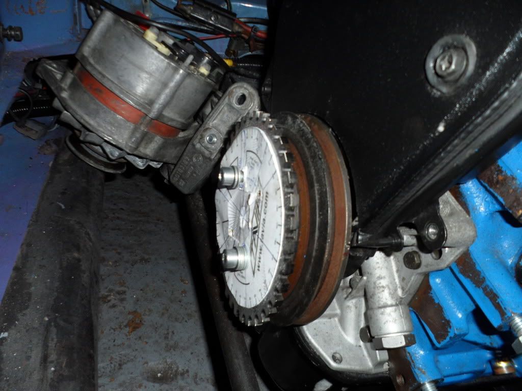

Megajolt trigger wheel redrilled and trial fitted to crank hub.
Photos show the crank hub at TDC with the missing tooth 90 degress past where the sensor will go. The sensor bracket will be knocked up next week. If I get this bit right I can actually run the engine in "limp home mode" running 10 deg BTDC through the EDIS module. The megajolt ECU will have to wait a bit whilst I get the funds together.

I do have a small observation/suggestion.....
Given the short lifespan of kevlar hoses, I'd fit a silicone hose in place of the kevlar hose that is fitted to the heater.

It's coming on great Ian, The turnkey moment is fast approaching! Still think that pipework is a birdsnest tho! Regards Steve

sprint95m wrote:Good progress Ian.
Yep, may do as I need small bore silicon hose for the bleed pipe. The black ones to the heater have been there for 15 years plus mind you...
