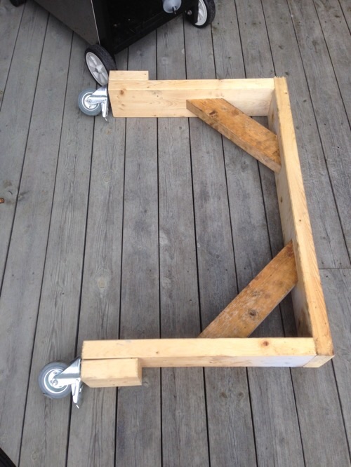

#121 Post by Norwegian sprint »

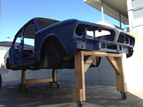

shaunroche wrote:Looking good!
Can we have more pics of the frame you've built to move it around on please? Very intrigued! :)
I don't have any good pic of the frame, and to late to take pic now, destroyed. :twisted:
Here is what i got....

Re: 1974 Norwegian sprint
#122 Post by shaunroche »
Love it!
Always think it's good to see the sorts of things people come up with to move their cars around and that's ace!

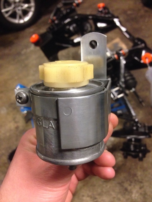

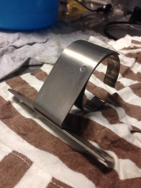

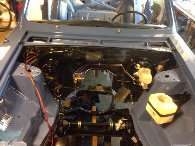

Things find it's way back "home" 8)
Today's quiz......
What have i done to my clutchfluid reservior and bracet?? :wink:
#124 Post by Pippin »
Top quality work, but why have you decided to move the reservoir from its original location?
Norwegian sprint
#125 Post by Norwegian sprint »
Pippin wrote:Top quality work, but why have you decided to move the reservoir from its original location?
Thanks for feedback. This is where the reservoir was located orginal :P
The reservoir / bracet is not painted, but what have i done to the finish of it? :wink:
Edin Dundee
#126 Post by Edin Dundee »
Nickel plate?
Norwegian sprint
#127 Post by Norwegian sprint »
Edin Dundee wrote:Nickel plate?
Zink plate, then polish :bluewave: :bluewave:
Pippin
Posts: 383
Location: Bristol
#128 Post by Pippin »
Norwegian sprint wrote:This is where the reservoir was located orginal :P
Oh, on my RHD Sprint, it's mounted on one of the suspension turrets, using one of the three nuts, not on the bulkhead where yours is.
Pippin
Posts: 383
Location: Bristol
#129 Post by Pippin »
Norwegian sprint wrote:Zink plate, then polish :bluewave: :bluewave:
I wouldn't expect zinc plate to stay polished for very long as zinc oxidizes very easily. This is why zinc is used as a sacrifical anode. When was the last time you saw any shiny galvanized steel (which is zinc plated)?
Norwegian sprint
#130 Post by Norwegian sprint »
uuhh, never tought about that :| ...
A friend of mine Do this zinc electro plating all the time, and the finish look shiny after years :roll:
I tought most bolt and nuts are electroplated using zink!?!?
I dont know, let the time tell.....nice looking now :D
